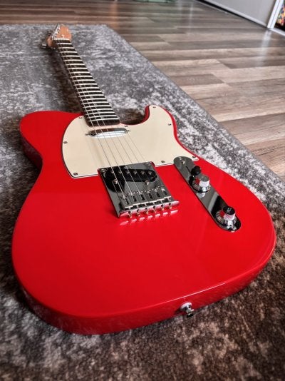

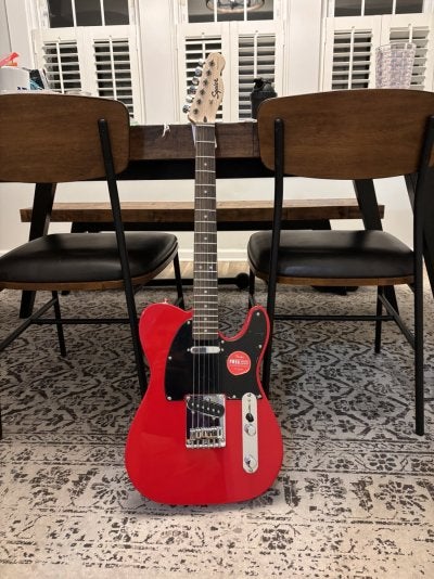

After a long lull in my guitar playing, I woke up on 1/1/24 and decided I'd get back in the swing of things. So I went out and bought...an Epiphone Casino. But then a month after that, the mom-and-pop store in my wife's hometown announced it was closing down and liquidating inventory, so we stopped in when we were visiting. Everything was very much priced to move, and the very last viable electric guitar they had was this:
I figured I'd see how much I could do to it for how little money. Having not engaged in any sort of guitar tinkering in more than a decade, I knew there'd be some mistakes. And there were a lot, but I'm pretty happy with how it turned out:
What I added:
  • 3-ply "aged white" pickguard ($11, Amazon)
  • Chrome-colored Strat-style knobs ($7, Amazon)
  • Bridge saddles from a Fender Standard Series (MIM) Telecaster bridge ($23 for whole bridge/saddles, Guitar Audio)
  • "Vintage Voiced" GFS Tele pickups with pre-wired "Kwikplug" system control plate ($65 all-in on sale from GuitarFetish)
What I did:
  • GOOD: Took my first-ever crack at fret levelling/polishing. The fretwork actually was pretty decent for such a cheap guitar—very few sharp edges to file. Still, they had some high spots and that dull scratchy feeling, so I taped the board, used the fret rocker, and sanded/filed/crowned/steel-wool polished to completion. And it turned out...great! No buzz, no snags, crisp action, great mirror shine. This neck really plays now.
  • AMAZING: Replaced the stock saddles with those from a Mexican standard bridge. The ones that came on the guitar were the 20mm type, with really long intonation screws. They looked goofy and felt weird, since I usually have my hand there when playing. Sonically, adding higher-quality 24mm saddles (and shorter screws) made a huge difference. The guitar sounds much more full acoustically and sustains a bit better now.
  • BAD: Attempted the old Kiwi shoe polish neck tint to darken up the bone-white, satin-finished maple. This turned into a whole boondoggle. I liked how it looked. I hated how waxy it felt. So I took the finish back down with steel wool, leaving a little glossiness and color, having wasted a good bit of time and shoe polish. I also left the headstock, front and back, with the coloration—giving them this weird fake tan look compared to the rest of the neck. I think I might strip the whole neck down and try a True-Oil finish to get it right once and for all.
  • MEH: Replaced the electronics with them dang cheap Guitar Fetish pickups and their goofy no-solder system. I know, I know—GF, plugs...but this being my first project in ages, I wanted to keep things simple and cheap, and it doesn't get much cheaper than $65 all-in or simpler than plugging in and screwing back together. The stock ceramic pickups just weren't it on this one. The bridge wasn't awful, it kinda had some nice trashcan Tele bite but was a bit too brittle. Stock neck pickup was awful, straight up muddy. These GFS replacements are unspectacular, but they certainly have much more body and definition and less harshness, so they're an improvement. That said, the tone pot in this system does not have very even taper, which I know is a common problem with GuitarFetish pots. You take what you get for the price—I'm an "always on 10" guy, so it doesn't bother me much.
Is it the world's greatest Tele now? No. But it's a much smoother-playing, fuller-sounding, better looking guitar than it was a couple weeks ago. Really fun, light, easygoing guitar to have around.
And I learned quite a bit, and I enjoyed it so much that I think I'm going to turn around and try to do it even better, as soon as the Surf Green Sonic Tele arrives in the mail this week. That one is getting the True-Oil treatment and I think is going to be set up as an Esquire. But for now, here are a couple more looks at this little red thing:

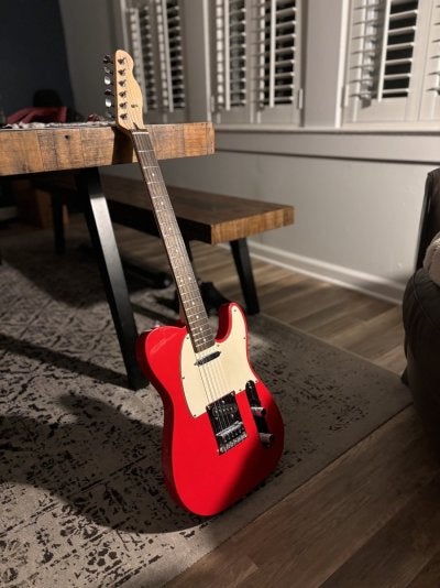

UPD: It has achieved its final form. Original stock pickup sounds great behind some higher-quality pots!
