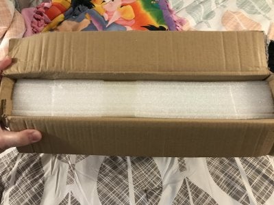

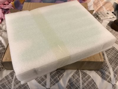

Well, impulse bought a T-Style body on eBay. This is my first Non-Fender body.
Did some searching and it appears in the past they had some shipping/packaging issues.
Looks like they solved that as my body arrived quickly and was packed really well and the paint looks flawless.
20210810_133417900_iOS.jpg 20210810_133441240_iOS.jpg 20210810_133522593_iOS.jpg
