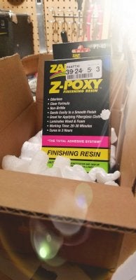

    The product I use is a finishing resin called Zpoxy. I buy it from LMII but I think it is available elsewhere on the internet. It is a slow curing material, takes about 24 hours to completely cure. It has a slight amber tint to it that may or may not be desirable (practice on scrap). It is forgiving about mixing ratio - I don't weigh it but rather just squeeze about the same amount into a cup. A little seems to go a long ways - I have finished a dozen guitars with my first 12 oz bottles
    https://www.lmii.com/glue/3050-z-poxy-finishing-resin-12-oz.html
    Most epoxies are soluble in denatured alcohol (DA) - you can use that for clean up and to dilute the resin. When you first mix some DA in it it turns cloudy, but with some stirring it will clear. We'll talk about dilution later.

    Freeman thanks for the enouragement - I tried z-poxy on a test piece of walnut over tung oil and got great results so this will definitely be in my arsenal from now on. Topcoated with Target WVX (waterborne hybrid alkyd varnish) without any adhesion problems oil-Zpoxy-WVX.
    In my case the tung oil on the test piece was cured for at least four or five months, but obviously for a finishing schedule I'd probably give it no more than a few days before sealing the grain. Have you had any adhesion problems with z-poxy over linseed or tung oil?
