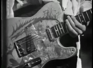

Its easy to see that this material was reflective and had relief under the guard.
Also there is something holding it in place in the center. Also looks like resin build up on the B & E string bridge pole magnets.

Cutting Lexan is harder than I thought. I was told that Polycarbonate material chips and now I know first hand. I'm new to all this stuff so after replacing blades with lots of teeth still scratching my head. If Jimmy Page cut his own pick guard then he had the same problems I'm sure. Some of my close up photos of Jimmy's pick guard, shows the horn area looking rough around the cut away tip, so I guess I'm in good company.
While I sort that out, I've moved on to the Dragon art. I've chosen my images and created layers in Photoshop to use as a guide. Instead of printing this stuff out I'm staring at a computer screen and mentally flattening the image as I hand draw the Dragon artwork onto a full size photo copy of the body. I'm looking at this as my practice run.

Here's one of my favorite photos of Jimmy playing the dragon.
It's a rare example of the detail with minimum color smearing.
