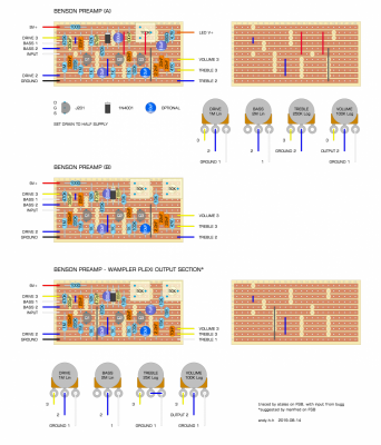

    I understand that this is the preamp section of the Benson Chimera, with the tubes replaced by FET's. But I am shocked at how much it behaves as advertised. By comparison, most pedals seem to impart a "flavor" to the sound of the amp, but they sound and feel just like that -- an added flavor. This doesn't.
    Can y'all explain why and how this behaves so differently, beside the obvious fact that this is actually an amplifier's preamp section? That is, what is different about the circuitry here than in other overdrive stomp boxes or the like?

    If I recall correctly, the sound of FET's, while SS, is closer to the sound of valves then NPN or PNP transistors. That may be one factor.

    A valve is a FET with a light bulb. FET circuits can sound fantastic and can display some rather graceful characteristics when overdriven.

    Freestompboxes.org has a long thread on it, in which the circuit is traced. Many people notice that it's almost identical to a Wampler Plexi Drive. Charles Benson himself chimes in and agrees that it's very similar, although he'd never seen a Wampler plexi drive before.
    I've never tried either, and of course small differences in circuits can make a big difference in sound

    According to the wisdom of the interweb it’s a pretty simple circuit with a low parts count. Found this strip board layout:
    theprofessor likes this.
