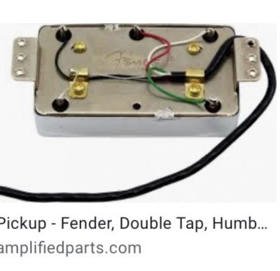

    Hi, I’m looking to setup a MIM player HH with 2 Fender Double Tap humbuckers instead of the stock ones.
    I have the HH wiring scheme with the standard humbuckers from fender, but the double taps are wired diffently.
    Wondering if anyone has ever done a tele with 2 double taps?
    I’m hoping to find a wiring scheme

    The double tap humbuckers are 4 conductor wiring so you can split the coils, from what you’re describing it sounds like the old pickups are two conductor. Are you going to add push pull pots or a mini toggle to split them or do you just want to wire them as standard humbuckers?

    Yes the idea is to split them with a push pull tonepot.
    I’m trying to do this standard scheme from the fender player HH, but the colors of the wires are different on the double tap. Can I do the same scheme?
    I then think that
    Double tap white = red on the scheme
    Double tap green = black
    Double tap black = white
    Double tap red = ?
    Double tap bare = green or bare?
    the wiring scheme i'm following;

    Ok it looks like on the player HH pickups, the white and black are combined together to make it humbucking. I found a diagram for the Double Tap on a Strat and on that it looks like the black and green combine for humbucking setting. I'm still trying to figure it out..
    Ok, it looks like hot on the Doubletap is white, red is the coil split hot, the bare wire seems to replace green on the other HH. You could use a multi meter and check if the black and green are tied together than you should get 8K ohms between bare and white wires and something less than 8K between red and bare.
    Something else I see on that HH Player diagram is they are wiring in reverse using red for hot on the neck pickup then green for hot on the bridge. It makes it tricky with the double tap because the bare seems to be not just ground but possibly the end of the pickup too.

    That diagram has some screw ups, on the back of the humbucker it has two black wires and no white, then where it shows the push pull wiring it says white wire from 5 way switch. Anyway from your first post question here's what I got:
    Double tap White = Red on the scheme
    Double tap Green = Black
    Double tap Black = White
    Double tap Red = Green
    Double tap bare = always grounded
    The green and black don't matter so much because they are connected together on the switch and just link the two coils on the humbucker. I had found another diagram from a strat and it was similar to the one you posted above. Fender just shut down their forums on 3/20 and my search results had a thread where somebody else posed a question and they supplied a diagram but the link doesn't work anymore, you could probably search google cached pages and find it. I had a feeling the doubletap doesn't fully split the coil but without a meter or connecting it you wouldn't be able to tell

    Ok so here's the result.
    Everything connected according the H H diagram:
    pos switc in bridge
    + pull activated: higher volume (compared to other tele) single coilish very thin, tone knob is working.
    + push activated: lower volume + tone not reacting
    Middle pos
    Much lower vol. push/pull functioning. Tone knob not working both in push and pull. perhaps a tiny tiny bit because the neck pup drags vol way down (see neck pos)
    Pull activated gives lower vol
    Neck pos
    such low volume I have to turn the amp to 11 and even then it's barely there. Push/pull seems to work, but tone knob does not. Pull activated gives higher vol
    Remarks
    - The volume pot is working in every position.
    - notice how the pull gives lower vol for the neck pup (as to be expected for activating single coil), and acts different on the bridge pup. Allthough i'm not sure if it's a volume boost or a frequency boost. it has the twangy sound. Nevertheless the Double Tap is made to have no vol drops/boosts from activating singlecoil vs humbucker

    OK I was able to find a cached version of the Fender support forum, the web page gives a security error on Chrome and Firefox so proceed at your own risk. I'm attaching the diagrams below, what the person did that worked was using a 4PDT (4 Pole double throw switch). The way this setup would work there would be no hum canceling when on single coil mode and both pickups on. The nature of the Double Tap is to not have a volume drop off so I think you're getting like maybe 70% of the pickup and not 50% like a typical split humbucker. If you were to wire one pickup in reverse to get hum canceling then I think the reverse pickup would be something weaker like 30%. You should still be able to split one pickup with what you have and hopefully I get an email response from Fender.
    Based on the new information it should be like this, you can look at the bottom of the pickup and it corresponds to the 4 corners:
    Double tap Bare = Green
    Double tap Red = no match
