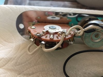

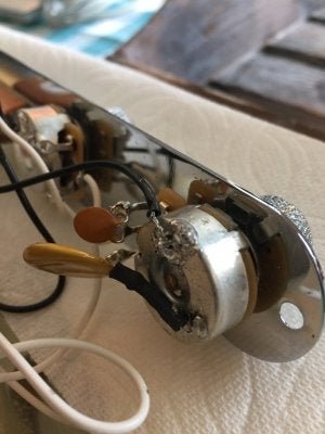

    I desoldered the prior pickups and am looking to solder in the Texas Specials. A few extra questions before starting. There are currently two caps wired to the tone pot (one that is tiny, labeled Y5U 104M and bridges two posts, and another that is larger and labeled Z5U 203M that grounds the third post). Most diagrams I see only have the single cap that is used to ground the third post. Additionally, you can see that my 3-way selector is wired differently than the one in the Texas Special diagram above.
    Should I just desolder everything as currently wired, and wire as closely as possible to the Texas Special diagram above?
    I've attached a few photos of the current setup. Thanks!

    I would just wire the three neck leads and the two bridge leads as you see them on the diagram I posted, keeping it regular tele 3 way., and check that the jumpers are correct as well.
    So you only have two leads to go to the switch, then ground the other three to the back of the vol. pot.
    If you want to go easy route on your grounds, that being not have to mess with soldering on a pot and ruining it, cut that black jumper about 1 inch up from the vol. pot, strip it some, and solder all your grounds to it, then tape it up good. Snip the other end of it (the black wire) on the tone pot as close to the solder as you can. There is no reason/need for those two pots to be jumpered together like that. Not to mention it is a sad looking solder job.:p
    Somebody did a grease bucket to your tone pot ( not that that is a bad thing or anything to do with a pup swap:

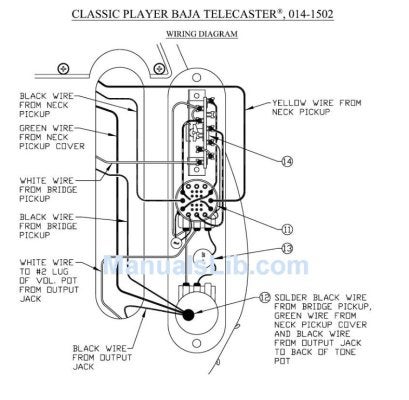

  11. Tuxedo Poly
    Tuxedo Poly Tele-Afflicted
    1,909
    Dec 19, 2011
    Merseyside UK
    Maybe stick with the Fender American Special Telecaster diagram. Greasebucket in all its glory.

    Thanks for the reply, guys! I think I'll just keep the grease bucket and roll with the diagram in the American standard wiring above. Last question; it appears that my tele only has one ground screw attached to the bottom of the control cavity, but does not have one at the bottom of the pickup cavity. Is that ok to bypass?
