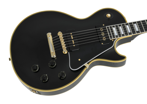

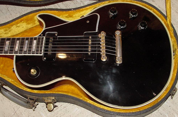

Browsing through photos of Les Paul Customs with dual P90's, I'm noticing some with the "staple" variety of P90, but in the neck positions only. Why is this?

Back in the early 70s, there was a pawn shop near where I lived that had a 1968 LP like the earlier pics. They wanted around $350 for it, and I lusted mightily. for it However, this was very shortly after I bought my avatar for $425, and just could not afford both (glad I kept the Martin)!

Might help to know how the pickup differs.
It is more like maybe a Jazzmaster pickup with alnico poles rather than bar mags underneath.
Bigger hunks of alnico but I guess Gibson wound a weaker coil too.
Similar to the old DeArmond Rowe Dynasonic with wide flat coil and big hunks of alnico inside the coil also adjustable for height with a complicated elevator system.
Not popular and short lived.
This is not an original and lack the elevators.
This has the elevators
