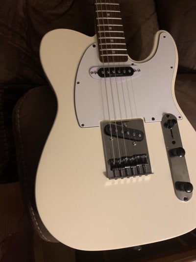

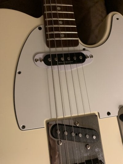

I made the mod by cutting out the smaller chrome tele pup template on a standard tele pickguard to accommodate the bigger Strat pup and laid a neat looking ring on top to cover the inconsistent xacto razor cuts. The strat neck pickup is an alnico that reads about 7k ohms/dc resistance coupled with a 10k alnico bridge. Been playing it for about half a day now and come to 2 thoughts #1 a strat pup in the neck of a tele sounds like a strat with a single coil pup in the neck and that’s redundant but a good choice if you prefer that legendary big full tone. #2 the middle switch position with both pups active do sound different (full, thicker and less high end) and definitely not traditional which may depend on the bridge pup specs. It’s really no different than a full size or mini humbucker in the neck seen over the years by famous players. The mod was definitely a success and very usable. I have other teles that will stay stock and traditional, this setup is just another option I have in my collection: a humbucker, mini bucker and now a standard single coil. I actually have 2 teles with 4 wire humbuckers in the neck on push/pull pots for various opinions such as series to parallel and the HOOP wiring (tried splitting coils but not a fan of ANY split coil hummer). These 2 humbucker neck teles give more tone options in the neck/bridge combo positions. I’m sure my efforts have all been done before just looking for thoughts, suggestions and even criticisms…lol. Burn away!

Looks great. How’s it sound? Is there a marked difference from a Tele neck pickup?

Played a Tele with a Strat neck pickup and humbucker for years back in the '80/90s.
Surprise, surprise... it sounded like a Strat on the neck pickup and a Gibson on the bridge pickup... mission accomplished.

Of course having a Strat neck pickup sized rout in my Tele would open up like 1000 tonal choices. I never got why Leo made them different sizes.

Took a while, but now all my teles have strat pickups in the neck position. Plenty of replacement pickguards out there custom and pre-made to handle the change. Sometimes a little dremel work on the body is necessary, but hidden by the guard. Love the sound!
There is a noticeable difference and I’ll try to keep it simple. Most importantly the 3 classic distinct tones are still there: the bridge is still a bridge, the bridge and neck still have the “bloom” quality and the Seymour Duncan neck is full and
It sounds great, typically like a sc in the neck without getting into details about a particular model which would probably be a subject for another post. Sounds full and articulate. My concern was the unison of the neck and bridge position together which sounds very satisfying, fuller and bigger than the standard chrome Tele pup and retains the classic “bloom” quality. I may try other pups in the neck as I installed a quick disconnect terminal for the wires before permanently soldering something.
