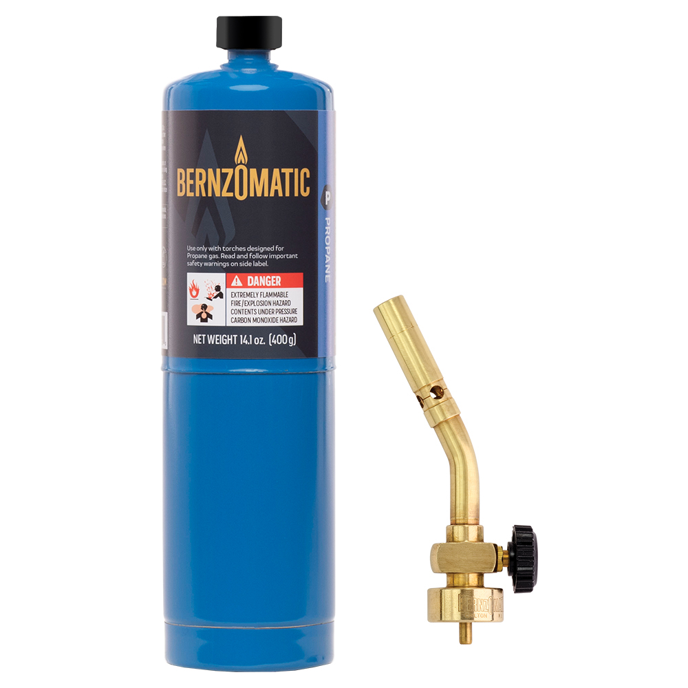

Really nice effect. "Torchified".
Any tips on technique?
Did you do the sides and back too?
Thanks. I used a basic torch kit. The flame is thin so it took some practice to get consistent burning. If I was planning on doing a lot of torching I’d look into a weed burning torch to get a wider, less intense flame. I started by going cross ways to the grain but that left streaks. Going with the grain gave better results. The tank needs to be upright to work best so the piece should be elevated. I was working with the body on the ground and resting against a log. It was a bit awkward.
I did the back and sides as well.
