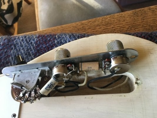

As for the caps? Maybe Chicago branded paper cap like this one?
