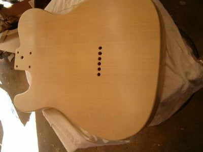

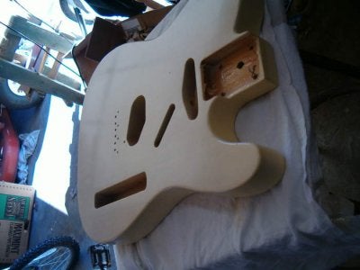

    blond t body 003.jpg []well after trying to flatten the lacquer I still have some orange peel but im afraid to keep going after 2 cans of lacquer it seems like its not enuff and I don't want to sand through . after posting pics I see you cant tell were its still not quite there. that re ranch blond sure changes color depending on the light

    If you're feeling that there's not enough on there then spray another can or two and wet sand again. I've seen people use 5-8 cans, some use only 3. I most commonly use 3-5 depending on how its going on, but I use something different from a lot of others. I use Watco Clear Gloss Lacquer.

    what do you mean you used 2 cans of reranch?
    I used about 3/4 of a can of reranch butt blonde and then 4 cans of minwax clear. the more color you use the darker and less transparent it gets
    i would say shoot a bunch of clear but then you'd have to wait another month or 3 before sanding again.
    just be very careful, and dont even look at the edges with sandpaper in your hands and you shouldnt get too many sand throughs

    I used about 3/4 of the reranch blond so it would be transparent and that was plenty I shot the sides a little more opaque . I sanded a little more orange peel out last night and have been using the mineral spirits. I may live with it I hate to put more lacquer on and wait 4-5 more weeks. this has been an 8 week project already.

    how much clear? I used 4 cans and still got a few very minor sandthroughs-no big deal though you dont notice after a few months because by then the guitar picks up some natural dings and scratches from normal play wear.
