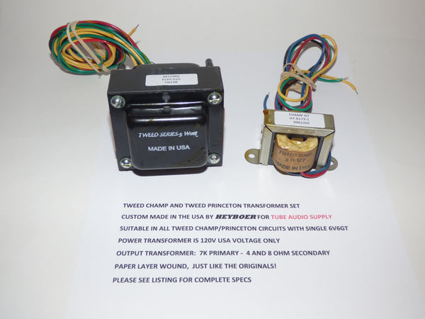

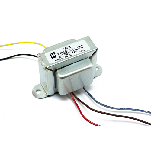

I was thinking Boothill’s chassis kit and these heybor transformers, Then source the cab and speaker from Mojo. That’s only 3 orders, and Mojo ships cabs for free. Thoughts?
I think you would be absolutely fine with this if Boothill have in stock. They do a great job in terms of capacitor and resistor selection (although I'm pretty sure you'd be fine with cheapo resistors too).

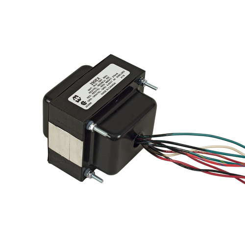

I would however definitely endorse the view that it's worth finding a Power transformer with a 275V tap. That's what I did for my 5f2a, following advice here. The Hammond 290CAX I think would be the one, and it's less expensive than many others. It's worht paying $5-10 more for an OT with both 4 ohm and 8 ohm taps as opposed to 4 ohm only, it's way more flexible.
I think if you want an 8 inch speaker that's what you should get. Alnico Weber signature 8 are a ridiculous bargain, likewise the CV8. I like Jensen alnicos but they're much pricier in the US vs Weber. Jupiter also have a new lower wattage 8 inch alnico on offer,
Thank you! I was looking at those transformers last night.
