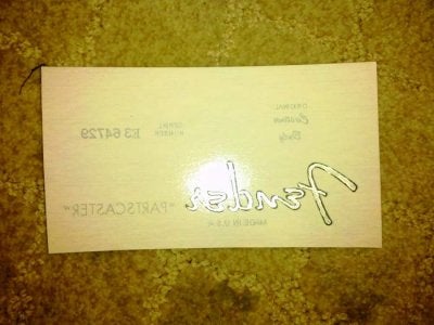

    Bought some water slide decal paper, and printed a logo on it. I know I have to give it a clear coat to prevent the ink from floating out, but this was just a test to see if the paper worked
    The transparent film came off after soaking it in water, but it didn't stay flat, but rolled and ended up looking loke a plastic tube...
    Would clear coat prevent this, or is my paper not working?

    You are supposed to wet it for a while and then place it decal side down on the job and then "slide " the top paper off leaving the transfer flat!
    Check some of Colt's threads on transfers he's an expert!

    Ok... Thanks :) need to flip the letters then...

    Yep! Letters must be mirror image!

    Decal printed as mirror image? It's been a while since I've done decals but I've never printed them as mirror images. The glue is between the decal and the paper. I lay the decal with paper in place and slide the paper out from under the decal.
    For ink-jet printed decals, I spray them with lacquer before applying.

    BartS - Just some observations from your post.
    If you are using a "ink jet" printer then yes you need to protect the water-based ink with a light spray of clear. If you use a laser printer you do not.
    When you soak the decal - only soak it long enough so it will start to move on the paper. The decal may curl with the paper on it but when you place the decal in position the plastic water slide should just slide off the paper backing and on to the guitar. If the decal is coming off the paper in the water then you are soaking it too long.
    If you use a laser printer you can print reverse images so you can use metallic paints (example attached). With the reverse image on the decal, soak the decal the same way but put a few drops of white glue in the water. Slide and apply the decal the same way - the glue adheres it to the surface. With the plastic decal now on top of the image it is protected by the plastic itself. Be careful building up the clear on top of it so you do not runi the decal - several mist coats are better than a wet coat here.

    I tried one more time, sliding the paper off, not printing mirror letters, but sliding the paper from underneath the film.
    Worked better, but I think my paper is no good. The plastic film gets almost gel like. I cant really move it, and certainly not iron out water, without it becoming a lump of gel.... Got the paper from China...

    With the decal paper I have, I print the logo in mirror image on the transfer and by doing it that way, the paper slides off the top of the transfer. Printing in normal image the paper has to slide from underneath the transfer making it more difficult all round.

    Decalpaper.com has never given me any problems.
    Buy LASERJET decal paper and print the black on a laser printer, not inkjet.
