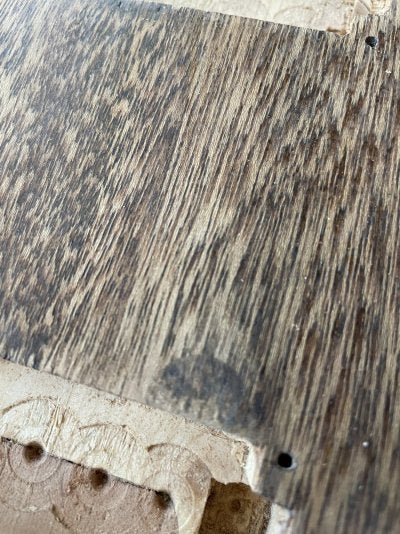

Here’s my patch after the glue set. I’m not sure why the glue line is so dark. Hopefully it will improve after I lay down some z-poxy.
Moldy, I had a similar problem with my latest build (glue line showing). I filled the slip up with glue and sawdust then a bit wood filler over the top. I managed to blend it in slightly but the Zpoxy actually accentuated it a bit after application. Hopefully it will come out ok after the clear coat.

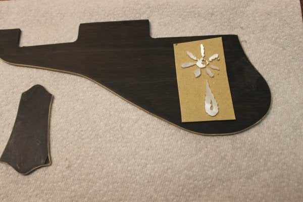

Not wishing to derail but I was about to start another thread re. finishing ebony. I have an ebony veneer (with plastic binding) on the headstock of my latest build and was wondering how to finish it. I am using satin wipe on poly for the the body and neck.
Apologies for the hijack but it could be relevant to the build? loving this thread and full of admiration for Moldy.
I’d definitely be interested in such a thread, never having finished ebony before. I’ll be spraying the guitar with nitro and I was planning to just do the same for the pick guard.
I have used ebony for fretboards (which are not finished) and the pickguards as shown. I can only give my experience. Ebony is not a porous wood so I have not pore filled it. Some ebony (the "Bob Taylor" stuff) has lovely lighter grey or tan streaks running thru it, I have heard of people staining that with India Ink to get it perfectly black, frankly I think its beautiful and so I leave it alone.
I just simply set the little pieces (pickguard, truss rod cover, pickup rings) on a piece of wood and spray them right along with the rest of the guitar. Headstock gets sprayed when I do the top. Probably ten or twelve coats, scuff sanded as usual, then buffed.
I want a tiny bit of the grain to show thru, I'm not trying to make this look like plastic./
Bottom line, its no different from any other hard wood.
Thanks yet again Freeman for your advice. Other suggestions have been to wipe with acetone first (same as rosewood) but as I mentioned I have used plastic binding so would be a bit wary. I'll just make sure it's dust free and try the wipe on poly.
