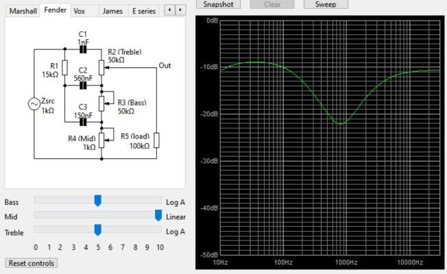

[✔] Changed the tonestack to match the voicing of classic VOX circuits. I have checked the curves of the classic Vox tone stack using the Tone Stack Calculator application. The curve of P10 was waaaaay off. P15r is a bit better, but still off. So here are my changes, using values of parts that I had. The pots do not track the same, but it's close enough. And the sound improvement was amazing.
Classic Vox tone stack
Modified P10 tonestack.
In detail
R10 - 15K
R11 - Removed and added a wire from its C11 pad, towards the junction between R12 and P3-pin3
R12 - 1K
C9 - 1nF
C10 - 560nF
C11 - 150nF

The tone stack is more like a Fender or Marshall topology.
Yeah the p10's pcb is a weird fusion. It has the left leg resistor R11 going to ground like old-school Vox, but follows the 90s vox layout on the bass pot, which is used as a variable resistor instead of a divider. All modern ACs and the 15r follow this fenderish layout.
And since I could not do old-school Vox directly without messing with the pcb, for simplicity and because I was a bit lazy, I went full modern-vox-style
For those that are fearless and want to go full old-school, you will have to find a way to separate the wiper on the bass pot and make the relevant connection. In which case you can also try to include how the pots track, by taking the tone stack of your favorite AC amp, and then accommodating for the 50k pots by just dividing each resistor by 20 and multiplying each capacitor by 20. You will have the same curve but a few dBs louder unless you also handle the output of the previous stage and the loading of the next stage to match those changes. (suggestion is courtesy of the awesome ppl at diyaudio)

I am curious about your tone stack mods if they made much of a difference.
The difference was quite obvious. Below you can see the response of the original P10 tonestack. If you compare it to the modified above you can see that the difference between mids-highs-lows is much more pronounced now. From ~7db to ~12db.

The first changes mainly affect the gain of the first stage at different frequencies. From a quick look, you should be getting more bass. But at the same time, because this is before/in the distortion stage, you might be getting some fuzz-like effect. I would imagine it something like how Boss BD-2 sounds if you get the gain too high.

Cool. But as said above, keep an eye on the bass from the first stages. If you go too high in gain, you might get some fuzz effect. Not that fuzz is bad if it's what you want.
