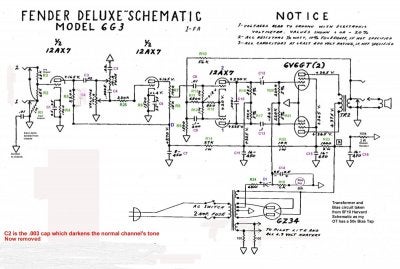

Hi
Burning smell from amp last night. Opened it up today and two resistors are burning up (see photo) - the 1K 2w voltage dropping resistor, and the 100K 2w bleeder resistor. Amp is a home built 6G3 lite (one channel, no vibrato). It's one thing to build an amp, but diagnosing a problem is a whole different kettle of fish. Any suggestions as to what might have caused this, or how to diagnose the problem would be greatly appreciated.
Thanks in advance, Andy, London, UK.

??? Overheating due to high current draw??? What are your voltages? Do you have a current limiter that could indicate a short causing excess current draw?
gusfinley
Jun 11, 2014
1,765
SLC, UT
Remove the bleeder resistor and throw it away. This burning up doesn't make much sense. After you figure out the main problem, you can put a new one back in.
If your dropping resistor is fried, you 've got to much current going through it, so suspect everything downstream of that resistor.
How does you bias supply check out? If this fails you could definately be putting yourself in an overcurrent situation.
It could also be a bad screen on your 6V6's. Do you have an old pair you could swap in. It definately wouldn't hurt to install some screen resistors in there. It will limit screen current and provide a voltage point for debug also.

seems like I've had bad power tubes do that.... be sure to check the rectifier too (GZ34)

What are the voltages? What is the current draw in each power tube? If a voltage chart was made when the build was finished, that would be a baseline to which one could compare readings....and that comparison might point to a problem.

Hmm, I'm trying to figure sequence. How do we test the circuit while it's burning dropping resistors? Not sure, how 'bout:
1. Build or hunt up your light-bulb limiter, to find shorts and prevent burning out the next set.
2. You're right about your old tubes. Swap in new or known-good rectifier and power tubes. If you don't have some, all tube amps need spares. JJs are fine for testing and startup purposes.
3. Solder in new dropping resistors, metal oxide, 2 or 3W.
4. Fire it up on the limiter, say a 60-100W *incandescent bulb.* Bright glow? Folks here can tell you how to localize the short using a sequence of tests with the limiter.
5. No bright glow? Pull all tubes, fire up amp and measure HT and filament VACs on the rectifier socket. Record on voltage table. Just for grins, measure 6.3v filament VAC wire-to-wire at the lamp and each of the other sockets.
6. If OK, still no tubes, power up and verify correct negative bias voltage is present on the control grid pin of both power tube sockets. Record on voltage table.
7. If bias OK, plug in rectifier, power up, measure plate voltage on every empty tube socket. They'll be high.
8. If all OK, plug in tubes (and speaker), fire up on the limiter one more time for good luck, *remove limiter*, fire up and play the amp. Sound OK? Now measure B+ nodes VDC to chassis at the positive end of each filter cap. Then measure plate, grid, and cathode voltages for all tubes. Record on voltage table. Calculate bias.
I may be wrong here, but some order of steps is gonna be important.
