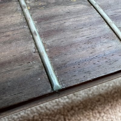

Fretboard wood looks pretty tired. Frets have light corrosion:
These flat spots looks like someone leveled the bass side of the frets, and didn't bother with crowning them.

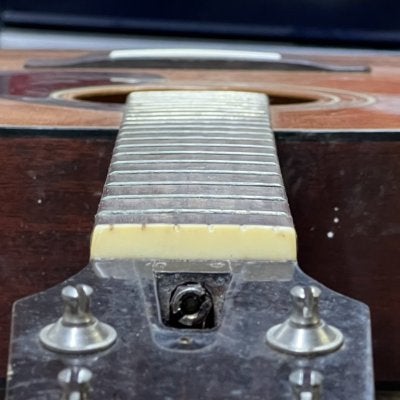

Now the neck geometry:
With the truss rod loosened and a straight edge between the 1st and 12th fret, there is 0.007" of relief measured at the 6th fret.
With a straight edge between the 1st and 20 th (last) fret, the relief is 0.016" at the 12th and 13th frets. This confirms what looks like a rise of the fretboard over the body when viewing down the neck from the head stock.
The fret plane projection to the bridge should be level with the top of the bridge. Here, it is below by about 1/8". Is this too far from ideal that reasonable string height can't be achieved?
Saddle is about 3/32" above wood.

Your last two photos tell the whole story. That guitar needs a neck reset and will never have nice playable action until it does. Unfortunately old Yamaha's are very hard to reset the necks on - they do use a dovetail joint but they either set them so tightly that they won't come apart with heat and steam or they use a glue that doesn't come apart like epoxy. A few folks have had luck resetting them but I have not.
On my personal FG-150 I resorted to the old trick of sawing the neck off and converting the guitar to bolt on. That allowed me to set the neck geometry such that I could get a very nice playable action with adequate saddle.
Some other options, none of them good, include trying to reduce the top belly with a Bridge Doctor, but honestly the belly on yours is normal (and I don't like the Bridge doc). Some people will shave the bridge but then if and when you do reset the neck you'll have to replace the bridge and Yamies are kind of odd balls. Your frets need some work and Yamies have low frets to start with.
If you have 0.007 relief between the nut and 14th fret that is pretty good and tightening the truss rod might bring it down a hair but that isn't going to improve your geometry. A big problem is that change in neck angle has created a bit of a ski jump from the 14th fret to the end of the neck, that is your high 0.016 relief from nut to end of neck.

The fretboard wood was white areas, stains and looked very dry. I found that a card scraper worked best to get down to good wood. Not only does the scraper leave a nice finish but it gets right in there next to the fret.

The frets polished up nicely. I used 3M WetOrDry Polishing papers. These are graded by the size of the grit in microns. I used 4 grits: 30, 15, 9 and 3 microns. In common sandpaper grades similar to P500, P1200, P2000 and P?? (no equivalent?). Amazon sells a sheet assortment of 6 grits for about 12 bucks.
After scraping the fretboard, I made a mixture of mineral spirits and mineral oil. I wiped on a wet coat, waited 20 minutes or so and reapplied everywhere. I checked it after about an hour and reapplied to any dry looking spots. I left it over night and gave it one more coat in the morning. Looks great.

Chaos, you are fighting the neck angle. One of the biggest dilemmas with old Yamahas is that almost every one needs a reset and they are darn hard to do. You can spend hours fiddling with everything else but until the angle is right you are spinning wheels.
At some point you are going to want to refret it, with frets out of the way you can do some work on the fretboard. I would suggest not putting a lot of treatment on the f/b - that can make gluing new frets more difficult. Another thing to really avoid is shaving the bridge (not the saddle, the bridge itself). People think they can't lower the saddle anymore so they need to sand the top of the bridge down, but when you finally do get around to fixing the neck angle the bridge will be too low. And, for what it is worth, Yamaha bridges are different shape from most other guitars so you can't just by a replacement.'
