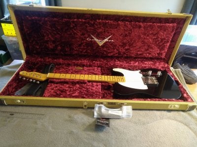

Today I received the Custom Shop Vintage Custom 1950 Esquire.
This link mentions "True to the original, this faithful recreation features a slightly thinner (1.5”) laminated pine body."
On the esquire I got this definitely isn't so. It's 1.75" for sure, just as thick as any other American made telecaster. Anybody else noticed this?
All the papers seem in order, it's got a lot of Case Candy and a COA but the specs are just wrong.
The neck has no truss rod, as promised, but has very thick poly like coating on it. Also not right, imo.
Anybody got thoughts on this?

Made me go measure my 50's Super Heavy Relic.....yup, mine measures 1.75", just like the rest of my Teles and Esquires.:confused:

I don't really know what a Flash Nitro finish on a neck looks like, but this coat is thick and shiny, like poly.
And about the body, my other teles are 1.75" too, but 1950 esquires were 1.50" laminated pine, meaning two slices of pine (sometimes chambered) glued together.
Check out this video! I'm after a thin guitar like that, I bet it feels great to play!

I've built a few to that spec, and they look and feel great. It's the same slab thickness as student models (Duo-Sonic, Musicmaster, Mustang, etc.). It is indeed one of the major defining features of the black NAMM Equires, and it should be there.
Somethin' ain't right with your guitar. The model number is identical to the one you linked to. But the specs don't match.
As for the neck, maybe you've just never seen a truly factory fresh ("N.O.S.") gloss nitro lacquer finish on a neck before. They are very shiny, and look deep and thick, even when they aren't.
The compound radius board and medium frets are glaringly "wrong" for a 1950 NAMM Esquire as well, as are several other features. But at least they match the specs list published by Fender online.
You shouldn't be going directly to Fender about this. You are your retailer's customer, and your retailer is Fender's customer. Move it up the "chain of command" in exact reverse order. Your business is with the retailer. The retailer's business is with Fender.
Bottom line, it isn't what Fender said it is. Send it back and get it replaced with one that is. And it should be your dealer handling every bit of it, not you dealing with Fender yourself.

Thanks for your comment!
You are absolutely right. I sent it back and will follow your advice on not taking this up with Fender myself.
If those specs were right on Namm's Esquires, it probably means that FCS built a couple of them and then switched to the nocaster bodies. I say that because the one I sent back is not the only one around. I checked with a big store in Germany and the sales person there was so kind as to check the thickness of the body on the same model. Guess what, 1.75".
Shame on FCS. These models are not cheap, and they should have the right specs!
As for the neck finish, you are right. Up until now I'd never laid eyes on a new gloss nitro finish before.
