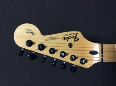

I'm in Japan and picked one up in unplayed condition. It was owned by a keyboardist and sat in the closet in a case for twenty years! I'm stoked!
I replaced the pick ups with Texas specials. Replaced the bridge with Fender a japan bridge. Replaced the tuners with Grovers. And, I replaced the sctracth plate with a 3-ply white and white knobs. I have ended up with an awesome Clapton Blacky replica. If you get a chance to buy of these and have the means to upgrade it I'd highly recommend you do so. The necks and body are US made and very high quality. The hardware is all crap, but once upgraded they are awesome guitars. Mine cost me less than 200 bucks in total and it's as good as an American standard Strat.

For some reason I could only upload one photo, so here is a photo of the headstock. The black hardware really sets it off! I painted the nut black too, just because I could. :lol:

LindsayX,
Nice guitar! I'm liking that blacked out look. My Squier Series is black too. I'll probably go to parchment/antique white guard and knobs when I do the pup swap.

Thanks Michael. It plays awesomely too! You need to get rid of the Squier machine heads too. I've never liked vintage tuners of any brand because you can't adjust them and the Squier ones are just garbage. I was considering going all out and putting a roller nut on it as well because the Squier nut is quite soft and will probably wear out in a year or three of playing. The roller nut requires a bit of sawing to get it to fit, but it's not too difficult. I'm taking delivery of my new MIJ TL62 ice blue Telecaster this weekend, so there is gonna be a bit of a dilemma in the ranks.
