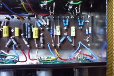

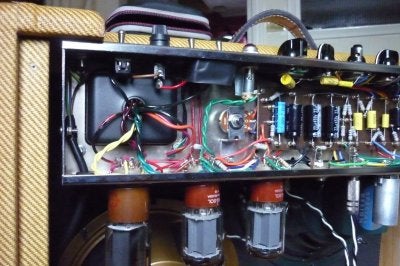

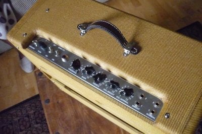

I have a tweed Super and it's glorious. There is one small difference between the Pro, Bandmaster and Super, which is the value of the negative feedback resistor. If you are scratch building, watch out for the value of the choke as a couple of the schematics are wrong. Also the OT; Weber uses the correct one, Mojotone doesn't, if I recall correctly. Hammond supplies the correct 6k OT.
Sound wise, it's a long way from a Deluxe. The bright channel is almost Blackface sparkly, with more kids and the normal channel seems more tweedy. The tonestack also adds more gain with a huge bottom end from a 2x10, with that swirly natural reverb. Mine runs 5881s, sweeter than a 6L6.
Edit-
I just checked and the Weber OT is the wrong spec at 4k. The Mojotone is partially there at 6K, but the Hammond 1760JB gives a broader choice of output values.

I like the Weber layout, though mine has an added bias pot. Mine had the wrong choke but I swapped it out for a bigger one. It also came with a 4k OT which adds a bit of headroom, so eventually it will get the correct 6k with multiple outputs like a Bassman. I reduced the coupling caps a bit to reduce the bottom end a bit too.
Uncle Daddy
Sep 26, 2015
3,653
Maldon, England
To get things right, you'll need one of these-
https://nextgenguitars.ca/products/hammond-1760jb-output-transformer-upgrade-2-67-4-8-ohm.html
and one of these-
https://www.tedweber.com/w014684
The Weber OT is the wrong spec, but the choke is correct.
Mine was scratch built on a home made turret board using what looks like a Mojotone chassis, and though the build quality was fine, (a retired IBM designer built it), some of the parts were incorrect due to misinformation on suppliers transformer charts. Even so, it still sounds pretty good; the 4k OT is still correct for a blackface Bandmaster with 6L6s, but the 6k makes it right.
Mine turned up as a Bandmaster 3x10 in a home made cab, so I got the guy who makes cabs for Rift and others to knock me up a Super cab, so it's now the size of a Hot Rod Deluxe. The Jensen P10r work well for that edge of breakup, and they're not bad at full bore either, but I threw the G10 gold in just to find out what it's like. Jury's still out, as I seldom get a chance to open things up.
