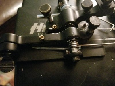

    i recently installed a g palm lever on my tele to go along with the b bender i already had.
    the problem is that using the b bender puts the g string a 1/4 or more flat (a string occasionally flat as well), and after taking it to a tech and contacting hipshot ive gotten no closer.
    I use nut sauce and have shimmed the bender plate to get a more downwards angle but still i have not found a remedy.
    any advice or solutions?
    any help is much appreciated! thanks

    hello, thanks for your reply. everything i have installed was ok'd by the tech i used. i did need to shim the plate to bring it flush to the face of the guitar.
    when i spoke with hipshot they said that when they make b and g sets they use a stabilizing screw on the steel rod, and mine would not have it as i purchased both separately. i am using all screws provided by hipshot
    the reasoning for the g going flat is that the pressure of applying the b bender causes enough flex to elongate the string, therefore making it flat. hipshot also suggested i bend the plate but i have no tool to bend steel. currently i have the g string strung up normally and no tuning issues whatsoever. 10-48 is my usual gauge of playing.

    If it’s not too much trouble, can you post pics of the guitar/Hipshot?

    here are some pics

    After looking at your pictures, It seems like the B&G mechanisms touch.
    They should be separated by snap rings.
    Perhaps thats the problem.
    Friction.
    Do you have the extra snap rings to go between the mechanisms?
    They serve as retainers/spacers.
    You’ll need inside and outside snap ring pliers.
    If you paid someone to install the G raise mechanisms, they should have installed the rings.
    Hipshot will have the rings, as should a well supplied hardware or auto parts store.

    here is a pic of when i initially installed it myself. the spacers are there but the problem still existed.
