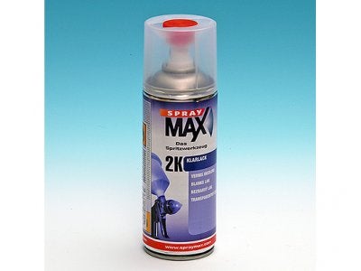

    I used this stuff as a clear gloss on the advice of a paint expert and it worked really well. Pretty easy to apply and dried very hard. Should be able to find it at any decent paint shop.
    The only downside is that once you trigger the catalizer inside you have a limited period of time to use it. So no matter how much you need, you end up killing an entire can.

  19. old wrench
    old wrench Tele-Afflicted
    1,529
    Feb 2, 2017
    corner of walk and don't walk
    That SprayMax 2K Gloss is a totally different animal from lacquer.
    It's a true catalyzed two-component finish.
    It really is a super-duper finish though; tough as nails :).
    I've been able to stretch out the pot life of a catalyzed can to about 24 hours by storing the un-used portion of the can in the refrigerator over-night. It was one of those unexpected and unplanned experiments that just happened to work ;).
