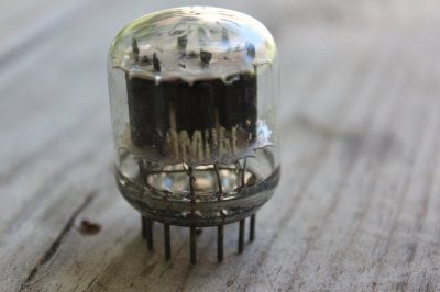

    I've still got to look at the trem circuit and try out some of the proposals listed here and elsewhere. But in the mean-time, a note on tubes:
    I got a few GE 6C10's -- two from an ebay seller who tests and offers free returns, one from a guy on TGP who had purchased it from Brent Jessee but had never used it, and another from another ebay seller that was NOS and NIB ("Admiral" labeled).
    There were some variations among them, notably one with a slightly taller bottle. Though most of the label was rubbed away, you could see a remnant of the 188 date code on the side. Interestingly, not only did it have "6C10" on the top; it also had a dot date code there.
    With that tube in particular, the amp was a LOT louder. A LOT. It was also more brash sounding, and it induced some noticeable hum from the amp. When I put it either the NOS GE from Brent Jessee or the NOS "Admiral"-labeled one from ebay in the same position, the hum went away, and the amp calmed down. It was not nearly as loud, and it sounded much more natural -- much more like I'd expect an Ampeg to sound.
    Another thing: the two 6C10 tubes that worked well are exactly the same size. The 6C10 that induced hum and that has the date code on the top is slightly taller. All these facts lead me to believe that the 1961 hum-inducing GE "6C10" (which I've returned) is something other than a genuine 6C10. I don't know what, but different. The tonality of that one was more akin to the Ei "6C10" tubes that came in the amp (which are thought by some to be re-labeled 6AC10's), but the bottle is not as tall as those. Somewhere in-between those tall Ei bottles and the correct shorter, stumpier bottles of a genuine 6C10. I do like the tonality with the brasher-sounding tubes. It is more aggressive in a cool way. But for now, at least, I'm sticking with the two GE 6C10's that look identically constructed, sound identical, and behave the way I'd expect this circuit to behave.
    I cannot prove that the one that doesn't sound "right" isn't a 6C10. Perhaps there is some other factor, such as microphony, contributing to the sound I'm hearing (but it doesn't sound like a microphonic tube to me). Perhaps there is also a margin of tolerance for how tall the bottle is on these tubes. But these things make me wonder.
    This is what a 6C10 Compactron should look like, size-wise:
    Here is the one that sounds "wrong" in V1, next to one of my two 6C10's that sounds "right" in V2:
