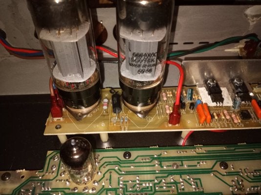

I recently picked up this amp for very cheap untested. The seller told me that it was squealing if it got bumped but it did turn on. Due to the low price I bought it without testing because I figured I could use parts off it if it ends up being a lemon. When I had time to look it over at home there was quite a bit I noticed. I first made sure the fuse was the correct value and that it wasn't blown. Then I took the back cover off to get better access to the tubes. I noticed the speaker was unplugged, so I put my meter across it to make sure it wasn't open. It responded with a little bump of the cone, so I assumed that was fine and plugged it back in. Being a little impatient and partly not caring if it goes up in smoke, I decided to power it up and see if there was any life in it. Looked to make sure the filaments were all glowing and noticed one of two power tubes was not glowing. Tried to get some noise out of it anyway and touched the input lead while messing with the volume knobs. There was no sound, not even a hum or crackle.
So I unplugged it, took the chassis out and attempted to pull the non glowing tube. The tubes are a little recessed into the chassis, so you can't really grab at the base of the tube but have to pull from the glass (Also as a side note, the spring retainers that go over the tubes seemed to have a bit too excessive tension on them in my opinion to be pressed against the glass of the tubes.) Anyways, the moment I grabbed the tube I noticed the whole glass bottle was loose from the base. It wasn't separated from the base, but it was loose and lost its vacuum. I tried to remove the other tube as well and surprisingly (even though that heater had been glowing) the glass of that tube was loose as well. So I figured those tubes are probably not conducting anymore. Those tubes that were in it were a matched pair of mesa 6l6gc's. All that I had on hand were some 5881's. I don't know what power tubes this amp was originally intended to have (I've been having some trouble finding information on this amp). I put in the 5881's and tried to get some sound out of the amp again. Still no sound though. So I decided to open up the chassis (kind of a hassle) and check out some more stuff.
First I checked to make sure I had continuity on the primary and secondary of the output transformer and not to anywhere it shouldn't. That all seemed to check out. So then I checked to make sure the tube sockets were getting the voltages they need. I checked for high voltage (I heard this amp has some known issues with the standby circuit. Instead of a mechanical switch, it is done remotely with a little push button switch and some FET's). I was getting high voltage at the plate, but I think this particular amp has those standby issues because pin 3 seemed to have high voltage regardless of the standby switch being on or off. On startup (with the power tubes removed) the voltage would jump up to about 440v and then steadily climb over the next minute or two to about 515v. The main filter cap is only rated for 450v and it looks a little bloated. I checked for negative bias and that measured at -32v (does that sound right)?. After I checked those, I put the 5881's back in and put my meter across the resistor that is on the cathode to see if there was any signs of life. Nothing happening cathode-side. (I should mention that after the amp was unplugged I put my meter in pin 3 to see how much voltage was still on it; and when I touched the pin, the speaker bumped a little. So I dont think anything is wrong with the OT). One final note, I had a new-in-box set of 6l6eh's that I was reluctant to sacrifice on this amp. But I finally put those in because I wasn't sure about the 5881's. The result was the same though. No output and nothing happening across the resistor on the cathode.
So I'm kind of at a loss of where to go from here. I kind of have a feeling that it's something to do with the power section/standby circuit. There is a number of transistors and the like in that area that might be messing with things. I also forgot to mention the power transformer was tweaked to one side and the preamp tubes and phase inverter are all rattly, so its safe to assume this amp had a good drop or two in its life. But if anyone has some idea or suggestions, I'm all ears and would appreciate the help.

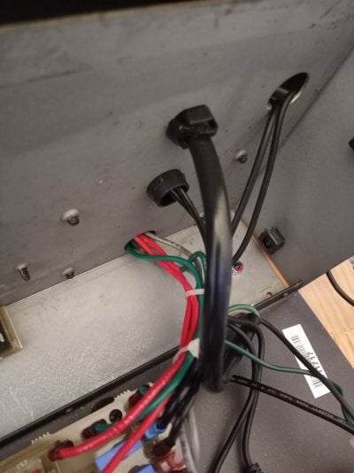

One last thing is this amp seems to be an older model. The power cable is hardwired to the amp. and in order to get into the chassis the power and output transformers come out with one half of the chassis and the circuit boards remain with the other half. It's an annoying set up to say the least. the newer ones seem to just have a lid that comes off with the all of the transformers and circuitry remaining in place.

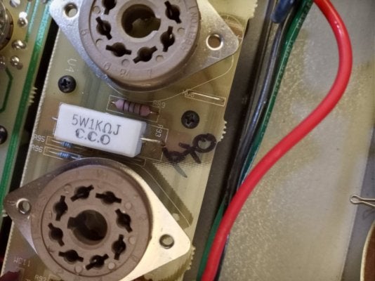

Silly me, I forgot to check the screen voltage. Measuring pin 4, there is no voltage showing up. Now just have to find out why. I don't see any physical signs like hot or burnt components. I still think it has something to do with some of those switching components for the standby.

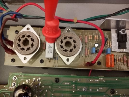

Ok, so I found a pdf of the schematics. Beginning at pin 4 of the power tubes and working back I started checking resistors with the meter. R89 and R90 are supposed to be 220 ohms. R90 was fine, R89 was a little low at 190 ohms. But the resistor next in line down from those two (R93) was reading open on my meter. To double check I powered the amp up and verified that the resistor was open. I had voltage on the incoming side and nothing on the side going to the tube sockets. I don't know if i should just change those components and hope for the best or whether if there is an easy way to check for shorted components down the C40, R94, and R106 branches which all are connected at that point. Do you think that the condition of the tubes as they were is a likely suspect for making that resistor go open? That (R93) is a 5watt resistor. The two screen resistors down stream from that (R98 and R90) are both 1 watt resistors. You would think that if the short was in the tubes, then those two screen resistors would burn up before that 5watt. But if the short was down a different branch, that would explain why the screen resistors are fine. Also I don't see any signs of heating or damage on any of these components.
Here are a few photos from today. And here is the schematic.
Also that main power cap needs to be changed.

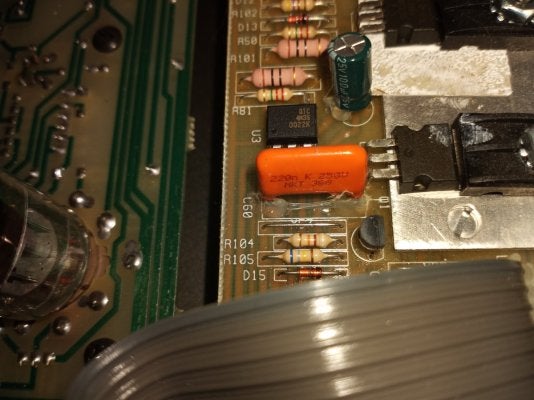

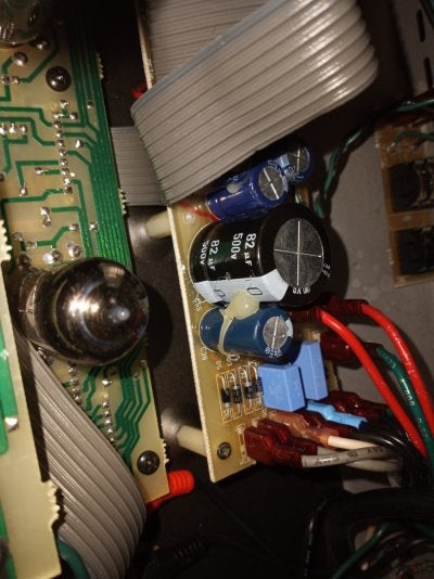

Checking near by components I noticed some discrepancies between my board and the one drawn in the schematic. The location of some of the components is different, but more importantly so are some of the values. My attention is drawn to this capacitor (C60). On the schematic it is listed as 10U 450v, but as the photograph attached shows, my board has a capacitor rated 220n 250v. I checked to make sure it was connected the same way as the schematic. It was, and R106 (which is supposed to be 100k) was measuring at 60k.
I don't know what the voltage drop would be across R93 and R106, but I'm thinking that it would still be a bit above 250v which that cap (C60) is rated at.
Also(I don't know if this counts for anything but) I measured resistance across the cap and it was at a steady 750k ohms. Is that enough to be safe to say that it is leaking? or could it be those zener diodes that are causing that reading? I'm not sure.

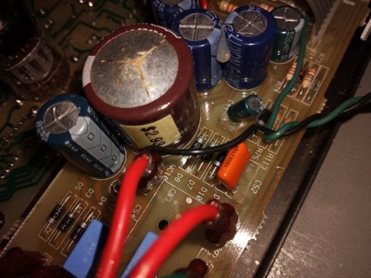

Some other things I noticed (which maybe I should have noticed before) were that the main cap has been replaced before. It was a 100uf instead of 82uf and it had the goofy price tag shown in the picture. It was kind of hidden on the back behind some wires. the power transformer could use some grommets on the secondary side for the wires going through the chassis. The Transformer was canted to one side like the amp had been dropped and the wires were pushed tight against one side of the hole. I bent the transformer feet back so the transformer sits straight now. The wires aren't pressed against the edge anymore, but it still seems like there should be a grommet there. Don't know if thats how they came or not. And finally next to the power tube sockets, what I thought was some letters abbreviating something, when looked at from another angle appears to be a little surfing dude.

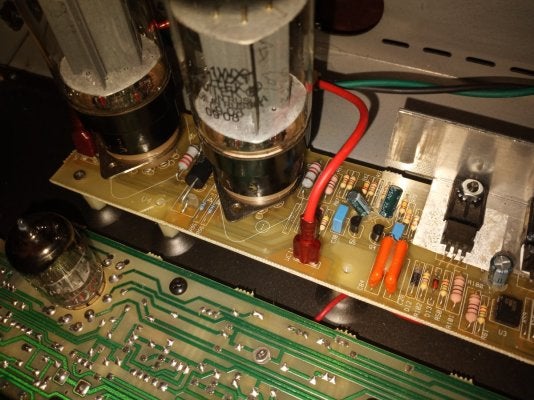

Changed out the screen resistors, changed the big filter cap, and added some grommets. put in some sacrificial 5881's. Seems Like everything is alright.
The plate voltage (with the current limiter in line with the amp) settled down around +394v.
I'll check the bias when I get some new tubes for it.
I'll report back if anything problems pop up.
