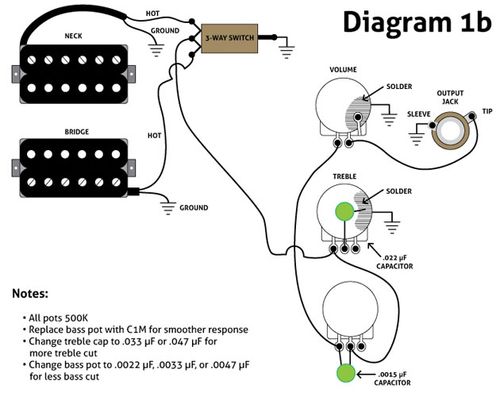

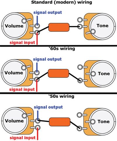

    Background: I have a Squier tele I'm looking to add a version of a PTB (passive treble and bass) control to as part of a full rewiring. I also intended to use '50s wiring on the guitar, which would have the tone control branching off from the output lug of the volume pot.
    The question: When I look up schematics for PTB circuits for 3-knob guitars, the order of components is:
    1. Pickups
    2. Switch
    3. Treble roll-off (usually a pot branching off the circuit, bleeding treble to ground in parallel as resistance accumulates)
    4. Bass roll-off (usually a pot wired pass-thru, adding some sort of series resistance)
    5. Volume pot (nothing special, but apparently needed after bass roll-off to make that control effective)
    6. Output
    On the other hand, '50s wiring in a Tele-like guitar would look like:
    1. Pickups
    2. Switch
    3. Volume pot
    4. Tone pot (branching off volume pot output lug, bleeding treble to ground)
    5. Output
    So here's what I am: I'd like to keep my tone (or treble roll-off, if I'm using PTB parlance) in the '50s position (parallel with output, post-volume), because the tone loss that rolling down volume brings on a pre-volume tone pot has been the reason I've avoided the volume control on guitar for my whole life. So that's important to me (and I so far haven't loved treble-bleed circuits as a solution either). But, I also understand that the volume pot's position after the bass-cut is essential to the bass-cut control actually doing something (series... resistance? capacitance? I don't know). Would a post-volume tone pot limit the effectiveness of the bass-cut? Should I just plan for my volume/treble/bass controls to be "very interactive," but otherwise expect things to work?
    My guess is the answer is "very interactive, but functional." I really hope I'm right.

    First, a bass cut control has little to do with the pot / resistance. Like the treble cut, the active ingredient is the cap. The pot is just there to allow some signal to bypass the filter, thus making it a variable control.
    Treble cut is cap in parallel with signal, and bass cut is cap in series with signal. Caps pass highs: starting at the very upper end of the spectrum, increasing the size of the cap widens the band that gets past the cap, which means including more lower frequencies. The biggest cap in the world :rolleyes: would pass all audible signal. In a bass cut circuit, a larger cap allows most of the frequency to get past it, and to the output. Smaller cap, more bass cut. In a treble cut circuit, it's the opposite. Larger cap allows more past it (as always), but in this case it's getting dumped to ground. So larger cap cuts more treble.
    Now, to your question. You can wire it thus: pickups --> switch --> variable bass cut --> vol pot --> 50s treble cut (and output to amp).

    You're right, if you're talking about treble and volume.
    Basically, the presence of the bass-cut control doesn't have anything to do with the location of the treble-cut wiring. They're totally independent and not interactive with each other. The interactivity is between the treble control and the volume control, just as expected in 50s wiring without any bass-cut control.

    I think you realize this, but you won't need a treble bleed with 50s wiring. That's one of the benefits.
