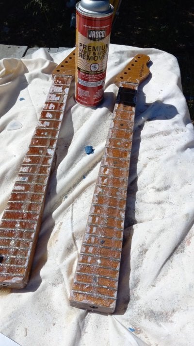

I had finished this one last year (actually two) but did not put them together. I had sprayed too heavy a coat on the neck and it needed to be stripped and re-sprayed. But I ran out of motivation. So this year while I was working on my two brotherhood builds I fixed the necks. It is a J.O.B. removing 2K urethane. Since I was unhappy with the neck pickup for my brotherhood build I removed it and installed that pickup in this build. With the Seymour Duncan Whole Lot of Humbucker in the neck and a T4 JB model in the bridge this guitar has attitude. While I cannot get those sweet tones for R&B rhythm, this guitar screams Southern Rock. The SH18 WLOH is a copy of Seymour’s early 70s London P.A.F. that he created by rewinding stock Gibson pickups. This build has the bolt on neck. I am completely converted to the set neck and the two bolt on ones that I am completing now will be the last I will ever make.

Nice man!!! Beautiful! You know, I was just thinking to myself "Hmmm.... if I ever had to strip a neck, how would I do that exactly and not screw it up?" So, you used that spray stripper to do it? How did that work out for you i.e. what was your process in working with that stuff?

Depends on what the finish is. If it is lacquer, you can use lacquer thinner. It will wash/rub off very easily with a clean cloth. Any of the 2 part epoxies will be tough, but this product says it will remove it. To get my 2K urethane off it took about 10 times putting it on, letting it set for 10-15 minutes and wiping it off.
