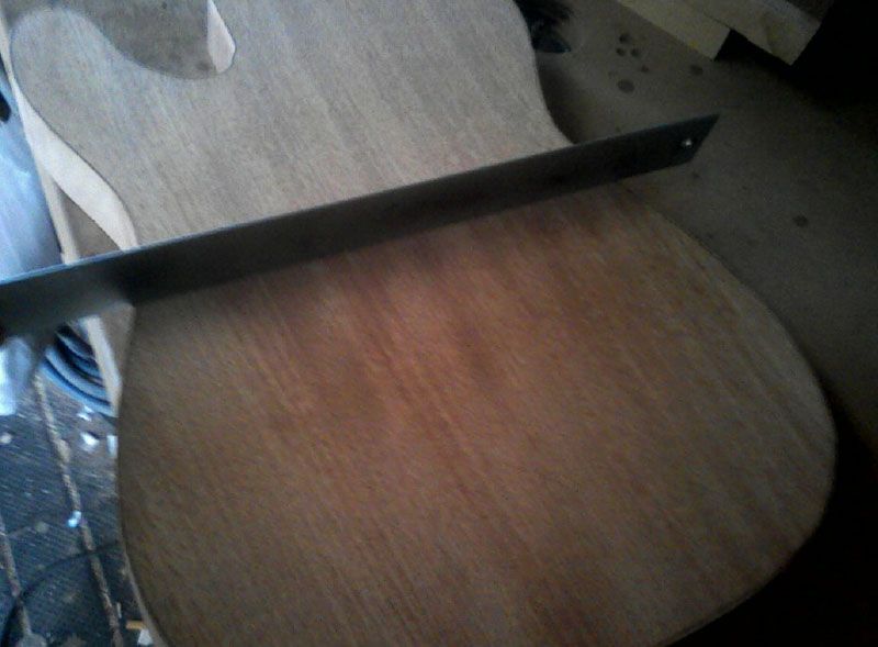

Body...
no warpage after initial cut
Thicknessing
Drilling the holes on the back
Robosanded
Final flush trimming

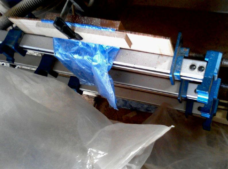

top is glued
Neck...
cut
and flush trimmed

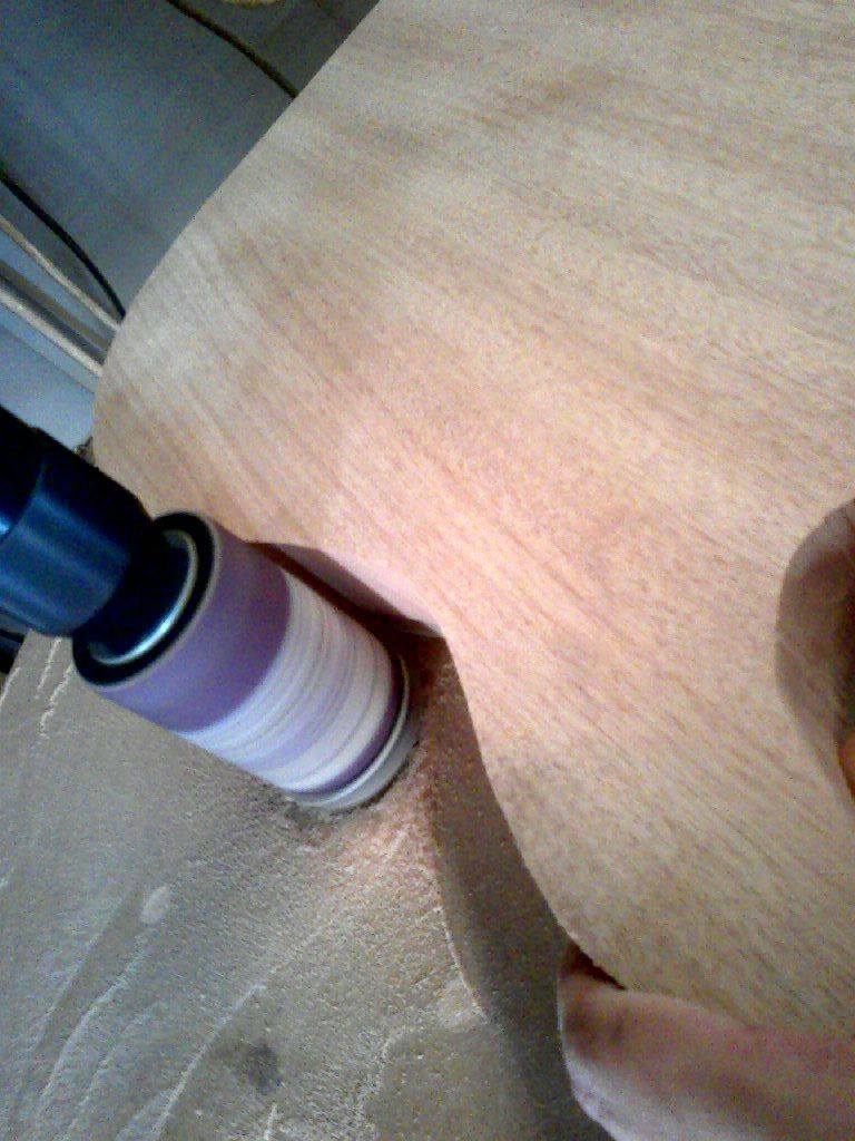

Thicknessing
Oooo, what is this nifty little sander gadget you have in the drill press. I like that, I can think of a bunch of great uses for one of those. I love reading your threads not only to see a master at his craft but I can get great ideas to use in my own garage.
Thank you again, Gil

Thicknessing
It's a $2 rotary sanding pad that does the same jog as a $600 thicknesser and takes a little less space (-;
I can also use any grit (5" sanding velcro discs) for different jobs.

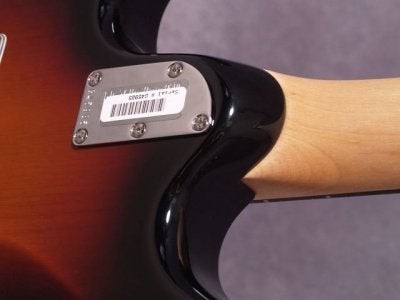

Since this is not a vintage theme - any thoughts on an improved neck pocket for upper fret access or perhaps how to do the cambering to balance out the neck's weight?
I'd like to second this -- I'd love to see you tackle an angled heel like on a Music Man. That is, if you're taking requests!
