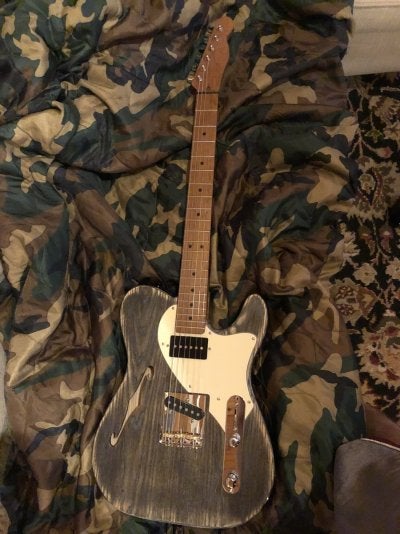

There are humbucker-sized P-90s; however I assume you are talking about a ‘72 Thinline Deluxe? The wide range humbuckers are larger than normal humbuckers. I think the pickup cavity in the body would fit a humbucker-sized P-90, but you may need a new pickguard. And likely a custom one if you’re going to keep the WRHB in the bridge. Hope that helps.

It will not fit in a standard Thinline pickguard. It won't fit in the pickup cavity underneath, either, though you probably won't have to remove much wood to make it fit.
The easiest way to go is with a new pickguard and an HB-sized pickup. No routing required.

The wide range humbucker is 3.125 wide (without the mounting tabs) A P90 soapbar is just a bit wider but doesn't have the tabs. If you look at ‘72 Thinline Deluxe bodies the rout is huge.
I would say it will work but you will need a P90 pickguard. P90's have been put in the neck position of Teles a lot, I imagine you can work it out fine.
The other nice option in a Thinline is a minibucker in the neck. That will fit readily, I've done it a few times.
