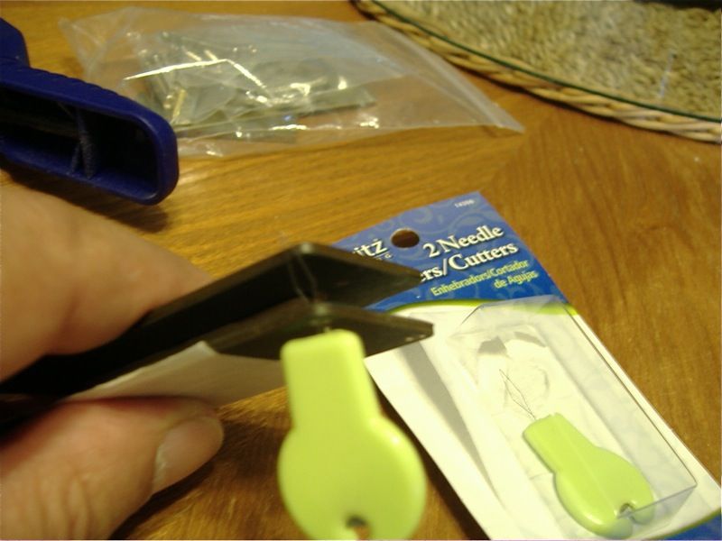

  17. nosmo
    nosmo Friend of Leo's
    4,580
    Jan 31, 2012
    Lake Jackson, TX
    Nice job TK. I like simple and it looks like you're not having any problems at all. This might be the only thing I can add to these winder threads - I also had a hard time threading the wire through the eyelets and then this idea popped into my little pea brain
    Kind of a fuzzy picture, but it's a needle threader. Works like a charm and they're really cheap :D
