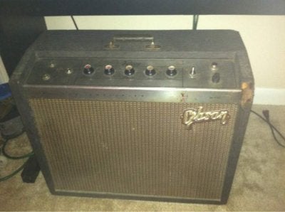

I was very excited to find this on Craigslist. It was listed as a 63 because it wasnt tweed. But once I got there and saw the finish, I got even more excited. It's a 61. It was pretty rough as you can see from the first picture. After cleaning it up a little and taking it in to my local tech to get a "once over" we discovered it still has the original tubes. There were several leaky caps which appeared to be the original. After plugging this in and playing it, I fell in love. Amazing sound. Can anyonetell me if the "top hat" type knobs are the original? Theres a 61 amp in eBay (for $1495) that has the "pointy" knobs and Im not sure which one is correct.

Welcome, Daytona. Congrats on the find. Yes, that cab style is obviously not a '63, ime. The rear-mounted controls were last built in 1961 sometime, I think. Knobs??? I think I see what are 'bell' knobs in Gibson world, and yes, those could be original...or not. Some amps from that period had 'chickenhead'---pointy-- knobs while some were transitioning to the bell knob. My near mint, all-oriignal 1960 GA100 Bass amp in tweed has black and gold bell knobs, but I have owned some of the small combo guitar amps from the same period that carried the chickenhead knobs.

Thanks for the reply Wally. It seems nothing was very cut and dry back then. Whatever was on sale I guess. Lol. Im impressed with the tone. Im an aging metal head and my tastes have certainly changed.
