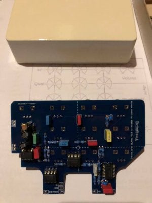

Started this build today and realized I got the wrong pots for Q and Frequency, ugh. Thankfully I found a drill template, it's not going to be a blast drilling lol.
I have built a couple of TH Custom's boards including their version of the ROG Supreaux overdrive, and their mono pedal size amp, both are cool. I didn't realize it initially, but there's an SMD bridge rectifier on the opposite side of the board. I didn't have a lot of trouble soldering it like I thought I would, but it's also a lot larger than an SMD transistor.

Yes, this is the PCB:
https://diy.thcustom.com/shop/3-band-parametriq-eq-full-control-pcb/
It's a 9V supply, with a charge pump to double the internal voltage. I decided to use different pots for the Q and frequency center controls, the plans call for the type without the threaded collars and I thought there might be more opportunities to cover drilling errors with the same type as the level controls. I'm not that good and don't have a drill press!

This one has been moving slowly, I wired it up yesterday and went to test today. Nothing, nada, hmmm. I wasn't sure about the one SMD on the board, a bridge rectifier. (I know, why for DC? It is taking the place of a reverse protection diode) I had a 50/50 chance of installing it correctly, and at the time I figured I did. Nope lol.
Now it's working, time for a decal!
