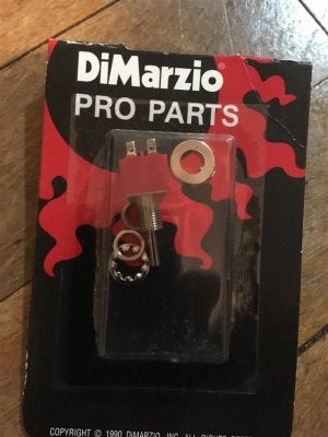

    So I measured the nut of a mini toggle I use, and it is 8mm
    The shaft of a CTS pot is 9MM. Not sure what their (custom) hole size is but probably not too much over the 9 I should think.
    The DiMarzio's I use come with washers so you could use those to make it work.
    https://www.amazon.com/dp/B003O4GRMY/?tag=tdpri-20

    Def worth a try. Worst case I’m out $14-15.
