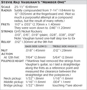

    This is from Dan Erlewine's measurements of #1 that he did for Guitar Player back in 1990 or thereabouts.

    That Erlewine measurement is unusual. All the single coil Tele and Strat pickups I have ever adjusted sent a balanced signal (equal VU meter setting) between the high and low "E" strings with the high "E" pole piece closer to the string. That measurement, along with Ceasar Diaz's amp mods and Stevie's use of 15" speakers points to a signal chain with accentuated low end at the source and speaker. That, and the heavier strings, would slap the preamp of his amps with a hot signal.

    All SRV lore aside, low pickups with low action would NOT do the same thing as high action.
    With high action, the distance from the string to the pickup changes as you play further up the neck, so the pickup output increases as you move up the neck, but output is lower when playing open chords.
    This happens with any action height, but the higher the action the more the distance between string and pickup changes as you pull the strings down to the frets and closer to the pickups.
