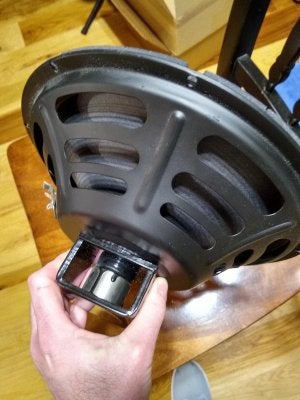

  5. Ess Eff
    Ess Eff Tele-Afflicted
    1,278
    Nov 6, 2018
    Earth
    jman72 likes this.

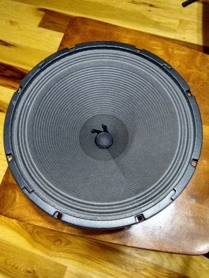

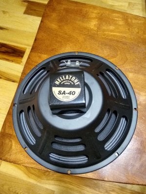

  18. jsnwhite619
    jsnwhite619 Friend of Leo's
    36
    3,442
    Sep 10, 2013
    Georgia
    Well, I'm officially a member of the TOO MUCH STUFF club or I'm just an idiot. I clicked the link above and as soon as I saw the speaker, it reminded me of something. Then I went and dug through my storage closet and pulled out a box on the bottom that a buddy gave me a few years ago for some cabinet work I did for him. Totally forgot I had this. So, guess what the first choice is going to be....

  19. Axis29
    Axis29 Poster Extraordinaire Ad Free Member
    6,823
    Jan 2, 2007
    Beaumont, CA
    I've only had a few speakers in my 5e3. It's a Cox Ultimate 5e3 and came stock with a Celestion Alnico Gold. What a fantastic combo! It sounded really Marshally... I mean in a great way. But, you had to have it cooking to get there. At low volumes, it was really dark and muddy. So much for a grab and go for small jams, or playing at home, quietly.
    I got lucky and scored a now discontinued, Eminence 1228. It's the alnico version of the '58 you have... and I had. I liked the 1258 a lot! But, the 1228 is the perfect pairing for a 5e3 as far as I'm concerned. It's also super light compared to the Gold! I have zero interest in looking at other speakers for this amp. If you happen to find one, hop on it! I know I keep an eye out for them.
    But, as I recall, those Hellatones got good reviews. Have you tried it yet?
