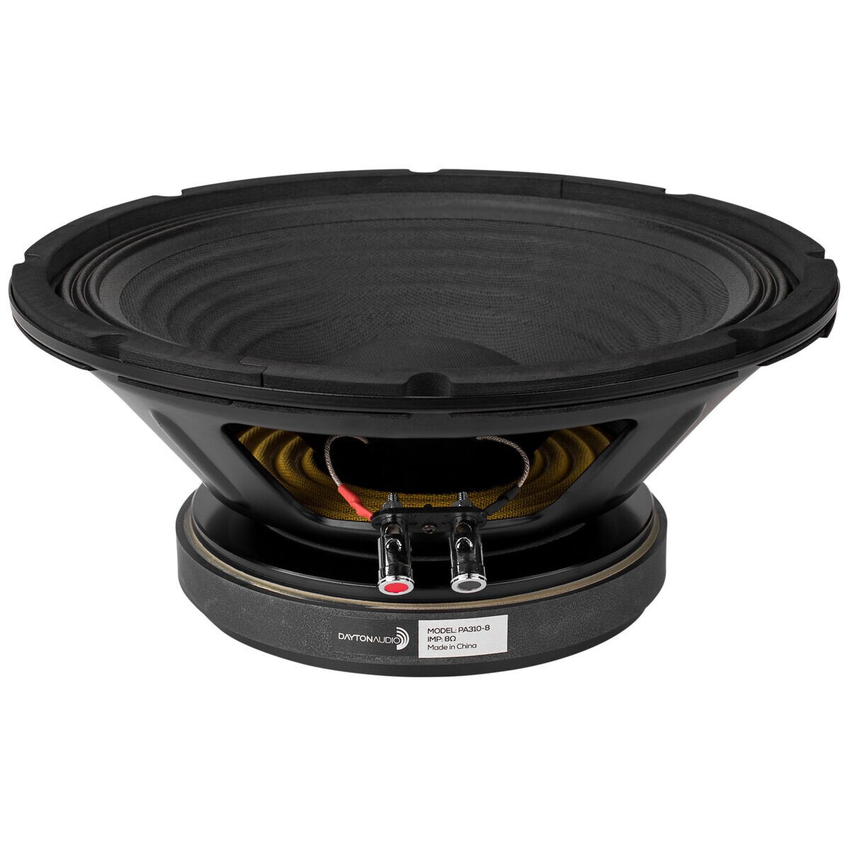

PA type drivers can work pretty well, especially in the case where you're after 'loud and clean' (my two most favorite drivers now both fall into the category of PA woofer/full range drivers). My tendency lately is for loud and clean -- in full disclosure.
As NoTeleBob says above, one of the key differences is that extended high end response up above about 5000hz-5500hz. Some players can deal with that ok and can find creative ways of downplaying it (by amp settings, EQ, PUs, etc). Having an amp (or EQ, or modeler, etc) providing active EQ provides the ability to 'add' and makes compensating for deficiencies much easier IMO.
I have one of these:
It provides a flat response (great with modeler, EQ unit, etc) and is bullet proof (very high power rating @ 450WRMS), moderate efficiency (96db) and has a response of 45-4000hz. It has LOTS of low-end -- especially in a sealed+ported box. Lately, I've been using it in an partial open back smaller cab and like it as-is. I tweak EQ settings as needed however.
There are other similar type drivers worth a look. A few that get used by guitarists fairly frequently are the Eminence Delta12A, Delta Pro 12A, etc. If you're willing to look at more strict 'PA' brands, PRV (Brazil) and Faital (Italy) make excellent PA woofers/full-range units. Some excellent ones can be had for prices comparable to what a decent guitar type speaker will cost you.
Good luck!
Good luck!
Thank you very much, it's great to get so much helpful information now, as I'm already getting a good idea of some decent options to consider.
Of course I need to buy the amp first. Hopefully the auction I'm currently following doesn't end up spiralling upwards outside what I'm willing to spend. Frustratingly I've missed the ends of a couple recently, both of which ended on prices I'd have been happy to beat!
