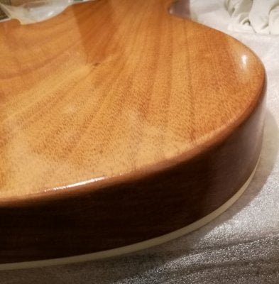

Hey guys. So I've zpoxy'ed 4 times and put probably 8 coats of amber shellac on and the color is about where I wan't it.
My question is where to go from here. One of the issues is that there are a couple of runs that I need to sand down but I get the feeling that this 8 coats of Shellac can be sanded through pretty easily.
- Should I continue with a few more coats knowing that sanding will knock back a layer or two?
- Sanding. Wet or Dry? should I be using 600, 800, or higher to get the shellac coat level?
- I've seen plenty of guitars with shellac as a final coat but I tend to bang my guitars around so something with a more protective coat seems like a good idea. Leaning towards Tru-oil, Wipe on Poly or (least appealing) wiat for spring and spray nitro.
Whatcha think?

Why are you sanding? Is the finish rough in addition to the runs, or are you just trying to get a better gloss? Pix are always helpful and appreciated.

There are a thousand ways to proceed from where you are. However, sanding any shaded clearcoat is fraught with danger because it is way too easy to get blotchy results; it's nearly impossible to evenly sand several layers of finish and maintain an even tint over the entire body.
If you can, carefully scrape the runs level and lightly wetsand with 1000. And proceed from there.
Yeah, It's a bit rough. Scraping sounds like the way to go in re: the runs. Then maybe a suuuuper light 800 grit level sand?
- Would maybe a dozen of tru-oil coats darken the tint from here, ya'll think?

It would - especially over time.
I like to form a scraper from a single edge razor blade. Drag the edge over a smooth, hardened steel tool several times at about a 30-45 degree angle. The resulting burr is then drawn CAREFULLY across the high spot.

Do not wet sand shellac, it tends to cloud up and you'll never get it back to where it was. I used micro-mesh pads on my shellac then applied 12-15 (20?) coats of tru-oil. Micro-mesh again then wax.

You can safely wetsand shellac using low-odor mineral spirits instead of water. I've had good results with it.
Matter of fact, I have not used water to wetsand any finish in the last 10 years or so. MS won't swell wood like water does, and it's safe to use on all cured finishes.

Be sure that that shellac has fully outgassed before you do anything...8 coats is a lot and shellac should always be as thin as possible as a coating. It's not like varnish or lacquer in that respect and thicker can crack/crackle. Sanding is just fine...just try to not cut through.

Here’s where I’m at.

That body is so highly figured that you can get away with a lot of variation in the finish. I'd strip sand the runs and dry sand with 800 or so. As long as you don't break through the shellac, it should be fine.
My plan was to gently scrape the runs (there's only a couple around the edges). Then sand lightly. Would you guys sand with the grain or do circular sanding? Do I need to wait for it harden more before sanding?

I think if you just worry about getting the shellac even right now, you'll be fine until weather conditions permit a nitro clear coat (or some amber, or whatever). Just handle the guitar carefully in the meantime.
Shellac may not be the greatest "forever" finish, but it should survive a few months of gentle indoor use.

Here’s the mock up….
the shellac seems a bit tacky. Should I wait a few days to dry sand? Could I have screwed myself with too many coats before sanding? Ugh.
