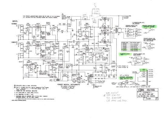

I recently acquired a non-working 1974 Vibrosonic Reverb and brought it back to life with new electrolytic caps throughout and new (freshly reconed) EVM-15L speaker. It now works fine... with all voltages correct(ish) per the schematic and everything else doing what it should. I love it, but find it sounds very ice-picky, especially at higher volumes.
I've made a few of the mods described by @robrob at his awesome website. These include adding adjustable bias, slowing the tremolo and reducing tremolo tick. I'll attach a schematic including my all mods below.
Mine is the push-pull master vol variant and before I saw @CoolBlueGlow's recent thread on taming the crappy pull-for-distortion function, I decided to delete that entire circuit and utilise the pull-switch for optional reduced NFB. So now the amp has the stock NFB circuit (820ohm w/100ohm shunt) when the switch is pulled, and light NFB (2.2k+820ohm w/100 ohm shunt) when the switch is pushed in.
To tame the ice-pick, I've put a 0.01uF cap across the stock 820ohm NFB resistor. I like what that does to the tone with the stock NFB setting but when I push the MV in for reduced NFB there's still too much ice-pick.
So I figure I need to add a cap across the 2.2k NFB resistor to let the ice-pick highs pass, but I can't work out what value cap I should put in parallel with the switchable 2.2k resistor to get the same frequencies bypassing the resistor as I'm getting from the the 0.01uF/820ohm combo. At this point my ambitions exceed my theoretical knowledge so I'm asking for help. Can anyone please tell me what value cap I should add where I've put the '?' on my attached schematic?
FWIW, the other half of the DPST MV switch is now spare and could be used if that helps.

Look up "RC filter calculator". You'll be able to plug in values for resistance and capacitance to get to the same frequency as your reference. This will get you there but won't teach you much.
Alternatively you can look up the equation for a first order RC filter and read up. Once you get your head around what you've learned, you'll see the equations for one set of components (R1 and C1) are equal to the other (R2 and C2) when you're wanting them to have the same frequency. Think back to your algebra classes to recall they can be rearranged such that if you multiply R1 and C1 that it should equal the product of R2 and C2. In other words R1xC1/R2 will give you the C2 you're looking for. Choose the nearest standard cap value.
Finally, if you try this and don't like the effect, then I would suggest attempting to tame the high end a different way that doesn't rely on the NFB. Some options are plate bypass caps on preamp stage triodes, a small value cap across the plates of the PI (maybe 470-680pf to start?), or the Vox type cut control that is illustrated on Rob's site. If you use a no-load pot for the cut control then it is totally out of circuit at max rotation.

Thanks for your reply @GotA24Fretter.
I understand, based on RC filter calculators, the .01 cap & 820 ohm resistor give a cutoff frequency of 19.41kHz, and
the cap required for the same cutoff frequency with a 2.2K resistor is 0.0037uF.
What I’m struggling with is:
1) I don’t understand how two RC filters in series will interact with each other.
I understand the two resistors in series will sum to 3.02k and the two caps to 0.0027uF. But I don’t know if that means I need to increase either or both of the caps, or by how much, to get my desired outcome.
2) The ratio of the NFB series to shunt resistor/s will change when the extra filter stage is engaged, meaning much less of the NFB signal gets to the PI. I’m not sure how (or if) I can compensate for that.
I think I need to look into your alternative suggestions for taming the high end.
Thanks again 👍

A couple things that I noticed in that schematic:
1. The coupling capbinto the PI is 0.0033uf (or 3.3nf or 3300pf), which looks like it was penciled in. The Fender amps could have anything from 500pf to 0.01uf. Higher values would be darker. What was the original value?
2. That 120pF at the master volume looks like it is there to add highs. Have you tried disconnecting it? This effect should go away if the master volume is all the way up.
3. The speaker may have the wrong conebor needs to break in more. How does it sound with the Allen amp?
Thanks for your reply @NTC.
1. Well spotted 👍. The PI coupling cap was originally 0.01uF (10nF). This change was recommended to let less low frequency through, thus preventing bottom end flub at high volume.
Apparently when Fender changed the PI grid leak resistors from 1M (BF) to 330k (decreased by 1/3, SF), they changed to PI coupling cap from 0.001uF to 0.01uF (increased by x10.) Logically a x3 increase would have been more appropriate, which is what I’ve done. I only made the change a couple of days ago, and can’t hear any appreciable difference in the high frequency response since. Bottom end seems a bit tighter though.
2) Haven’t tried disconnecting the MV bright cap, because I’ve been keeping the MV at 10 to keep that cap out of the equation. Tempted to give it a go though.
3) Just tried the Vibrosonic through the Sweet Spot’s speaker. Was hoping this would be the ‘aha’ moment, but ice pick highs are still there if I dial up the treble past about 3.5.
Another observation FWIW: I’m getting the same symptoms on both the normal and vibrato channels.
