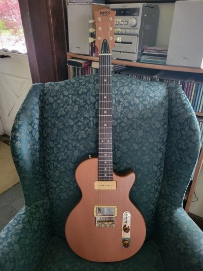

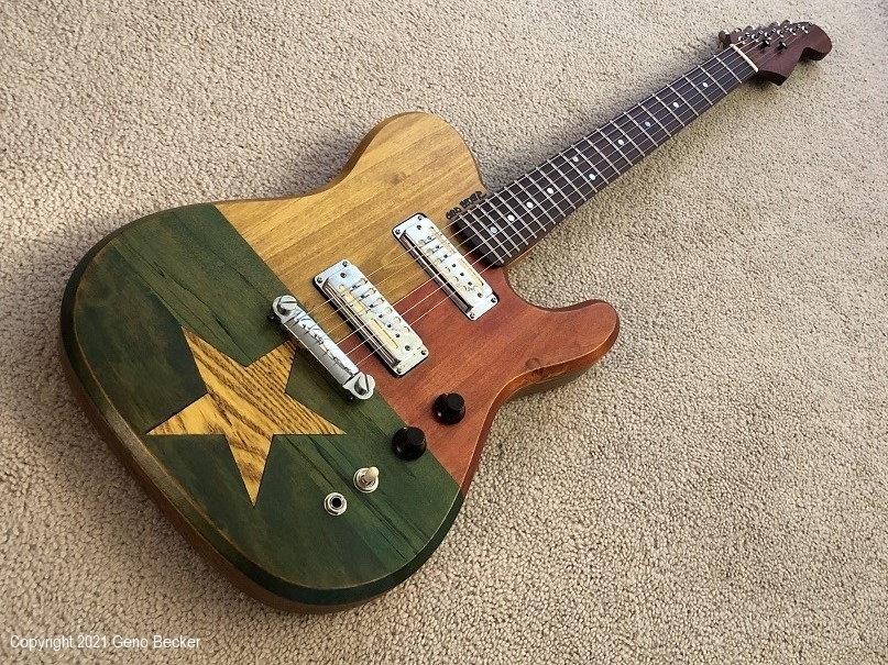

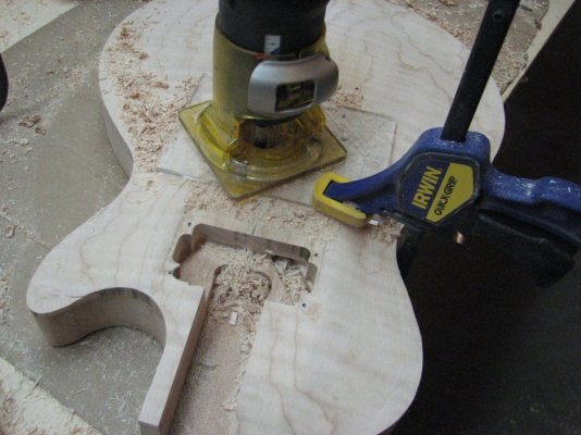

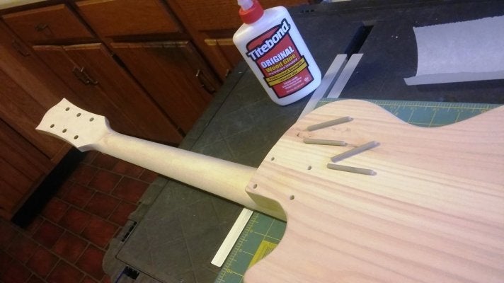

I'm not sure if you're talking about a scratch build or a partscaster, or if that even matters. Here is a set-neck LP Special-type partscaster project I finished in the spring. Also, my first full paint job. I think it turned out great.

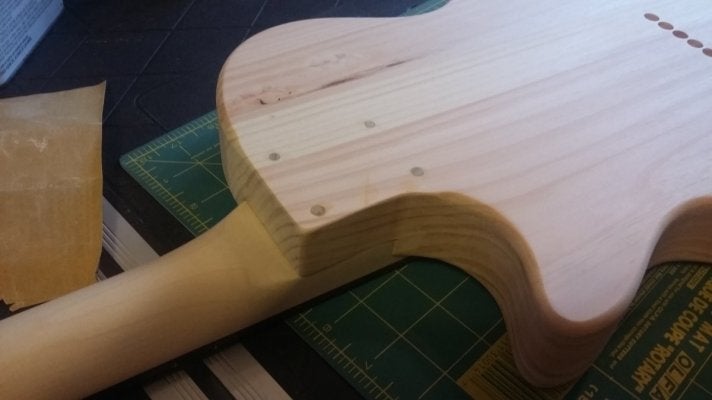

I totally winged it using parts made for a bolt-on (Rosser eastern white pine body & a maple Warmoth Hombre neck). I did a dry-run bolt-on fit first to make sure my neck angle would be OK (the Tele short bridge didn't require any neck angle, but I believe a Tune-o-matic would.).
Then I glued the neck in using original Titebond. Since I had to fill the neck holes in the body anyway, I drilled them through into the neck and glued in 3/16" poplar dowels, which essentially replaced the screws for some added strength.
Not your traditional mortice and tenon, but it's plenty solid and a little sleeker at the heel than a regular LP.

Hm. The dowels are a neat idea. That turned out really well!

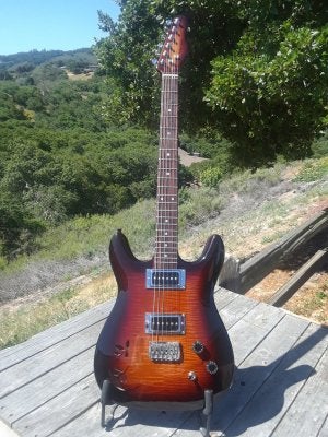

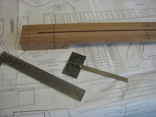

A set neck in my book is a mortise and tenon joint. It's harder than a bolt on neck joint, but not impossible to do. The proper tools help a lot. You've got bridge choices to make. If you want an F style bridge you may be able to get way with little to no neck angle. If you use a G style bridge than that could require a neck angle to achieve the proper action. Gibson did do some SG's with little to no neck angle in the 70's, but they are not the norm. I have used a router table and hand tools to make my set necks more often than not.
Here is one version of my necks I did:
and another
and one I need to finish up when it cools down:

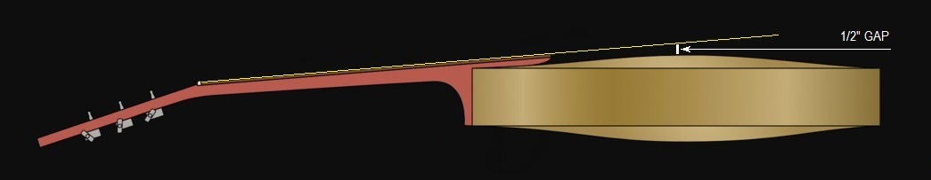

In my humble opinion, a "set neck" is one that is glued into the body of the guitar. It can be a variety of different joints but the important thing is that the geometry is "set". With acoustic guitars we talk about "resetting the neck" to change the neck geametry as the guitar ages.
The key to understanding the geometry of any guitar is that in most cases you want the fret plane to just touch the tops of the saddles when they are at their very lowest adjustment, that gives you enough adjustment to get good playable acation and still be within in the adjustment range of whatever bridge you choose.
I've written a little dissertation about how I think neck geometry works on two very different styles of guitars
Hey all. I'm starting to plan a new guitar build and I'm thinking of going with a set neck this time, which would be a first for me. So, I thought I'd do a call out for some advice on this. I'll also be doing a deep dive into my guitar building books.
Questions:
Will this be much more difficult than a Fender style bolt on?
When is a non-0 neck angle required?
Other than being associated with cheap instruments, is a scarf joint all that bad? Are there other methods you'd suggest?
Is there a neck joint style you've had good/bad luck with?
Any jigs I should look at making?
Bonus question: does a tune-o-matic have to be angled? That one's always confused me.
Is neck-through easier than set neck?
To your specific question:
1- your guitar building books should include Melvyn Hiscock's Make Your own Electric Guitar He answers a lot of them for you
2- it is definitely more difficult than a screw on neck
3- neck angle is determined by your geometry. Zero is an angle and is perfectly acceptable. Classical guitars even have negative angles.
4 - I use scarf joints on all of my heads. It is much stronger that a one piece neck and save a considerable amount of wood. I don't associate it with cheap instrurments at all
5- dovetail joints are elegant but difficult for a beginner to understand and get the angle correct. I personally don't like full width tenons, they are poorly supported and hard go make them lookd good as they flair into the body. Stay away from the Gibson "short tenon". I've never repaired a long tenon, did have to repair a short one (and told the owner that it will probably fail again).
6- I make jigs for cutting the scarf angle (I use 14 degrees) and I make templates for the tenon. If I'm doing a dovetail I have a special jig. One good thing to think about is making as many cuts as possible with the sides of your neck blank square and parallel. The minute you start cutting angles things get harder.
7- If you are talking about angling a ToM bridge with respect to the center line, yes. They do not have enough travel to compensate the strings if they are installed perpendicular. If you are talking about the stud being angled with respect to the top, no. You want the studs perpendicular to the top.
8- Neck thru is quite a bit harder to build because you will have to cut the angle at the beginning and deal with the area at the body joint. They are also longer and awkward to deal with on your workbench. Hiscock has a neck thru as one of the guitars he builds (also a set neck and a screw on), you can see some of the issues.
I'll add that I think a set neck is the way to go with any Gibson inspired guitar or any time you have an arched or angled top. I think the transition between the neck and the body can be much more elegant, unlike screw on necks which to me look clunky. Screw on necks have the big advantage that you can screw around with them until the geometry becomes right. With a set neck you better have it right when the glue goes in.

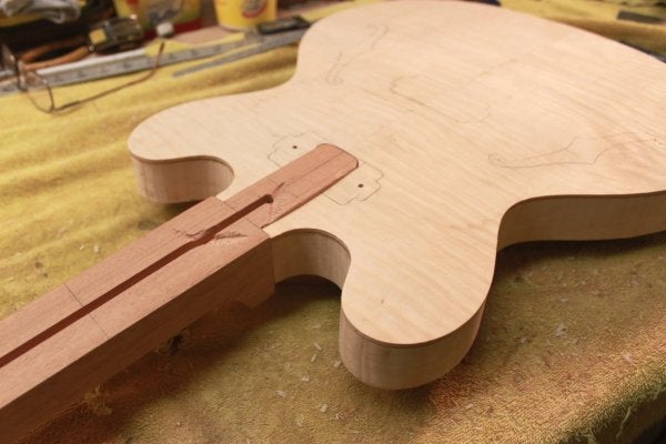

Various set necks, this is a les paul style with arched top, 3-1/2 degree angle, no overstand, ToM bridge
Semi hollow, similar to the LP

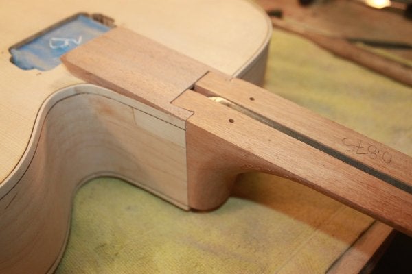

The tenon on a good set neck should be a snug but not tight fit in the mortise. Here is another lester, no gluein the joint yet. I use the same template to make the tenon and the pocket which ensures they will fit (note that the neck has not been shaped yet)
double neck, again 3+ degree, ToM's
Dovetail
By the way most of those guitars have build threads where I show the setting of the neck. If you would like a link to any of them let me know.

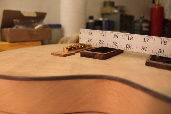

@Rigel7

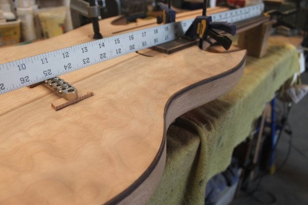

When I build a set-neck for a tune-o-matic bridge (solidbody or archtop), I shoot for a 1/2" gap at the bridge location between the face of the guitar and a straight edge resting directly atop the frets on a perfectly flat neck. It has always worked great.
I did the same with this guitar because I used a wrap-tail bridge, even though this one has a screwed-on neck.

^^^ I do this with the actual bridge that I'm going to use. Put it on a couple of little wood blocks the height of the studs and bushing and set the neck angle so the FP touches the tops. Mine end up a little higher than Peegoo's

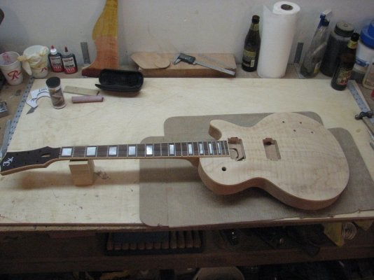

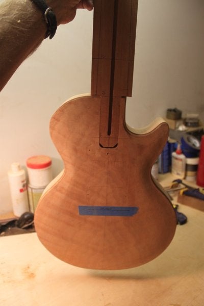

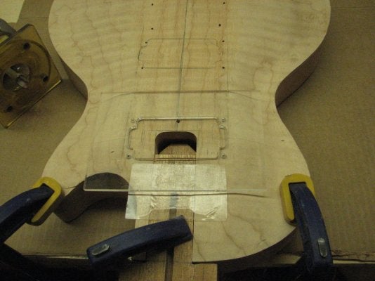

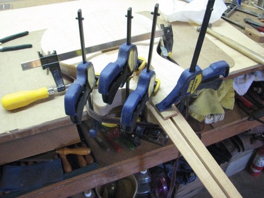

Since I'm bored I though I would just post the sequence that I use when I do a les paul style long tenon set neck. I use a 1 x 3 piece of manhogany 36 inch long, I can get everything out of that with little scrap
Do the scarfed head and stack blocks for the heel. There are lots of threads about scarfed heads, just be aware that things want to skate around on the slippery glue. Route the truss rod channel while you've got square sides (the blue tape is the end of the channel
Make the body and angle the neck extension per your calculations or plans. LP's are typically 3-1/2 to 4-1/2 degrees
Transfer that angle to your neck heel
lay out all the other cuts
and cut the heel "cheeks"

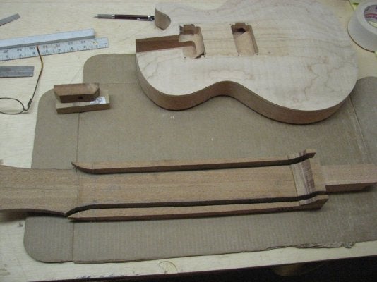

Build a template for the tenon, clamp or screw it to the guitar, drill out waste and route
Cut everything on the neck that you can using the flat square sides
Now you can start carving your neck using whatever method you like. I use a combination of facets and templates, spoke shave and scraper.
Floss the cheeks so the fit nicely
I've come to the end of the number of pictures I can post so I'll start another one
Freeman Keller
Aug 22, 2018
15,880
80
Washington
Continuing the set neck

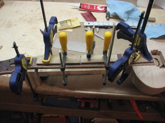

Clamp the neck into the pocket and route the neck pickup cavity. The neck extends under the pup to get more gluing surface
Another view you can see the channel running at an angle thru the pickup cavities for wires to the switch and pups
I build the fretboard separately from the neck, time to do that. Headplate, veneer, inlay double acting truss rod, binding
Fret it
Finally clamp it all together again and double check the geometry. Last chance (this happens to be a differen guitar, I didn;t have one of this stage for the lester). The bridge is sitting on two little blocks of wood that emulate the posts and inserts, this would be the lowest it could go
Glue the neck to the body ("set it")
Glue the fretboard to the neck
And you've got yourself a set neck guitar
