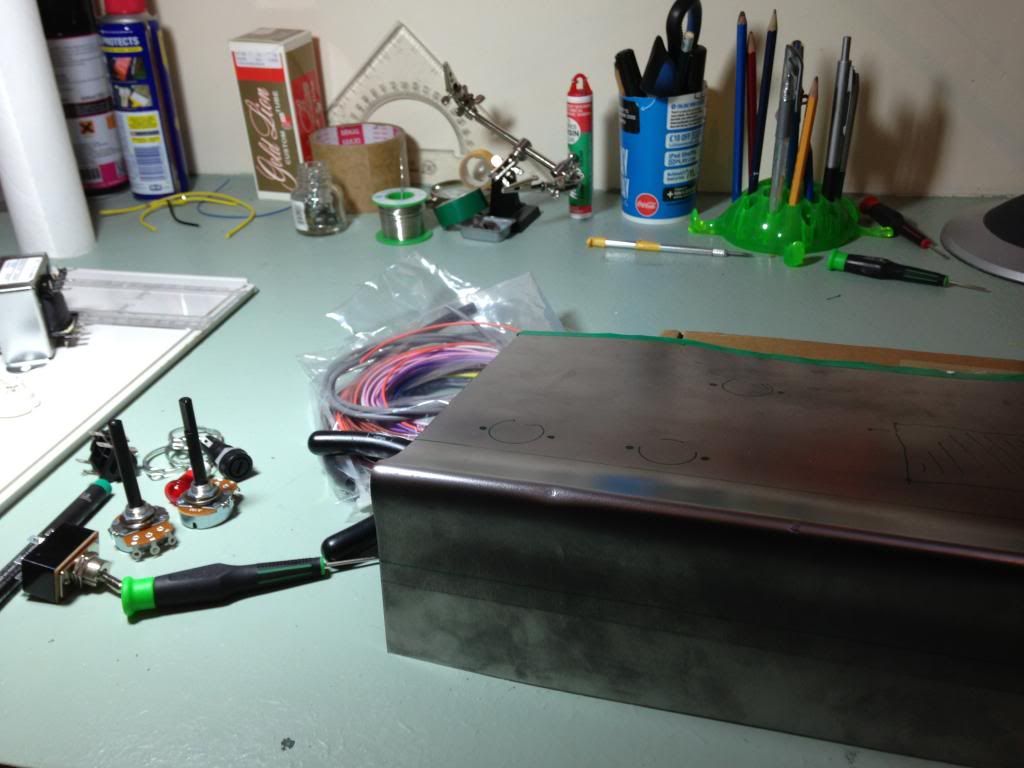

Parts are all here; the chassis is about as crude as could be, (just a bent piece of 1mm aluminium cut to size with tin snips) I'm currently waiting on a Dremel and step drill bit to cut the tube socket holes and the cutout for the power transformer so unfortunately I won't be able to start wiring until the weekend. I will probably swap around the switch and the fuse, so the fuse is closer to the end of the chassis.
I think I have the general layout down, I have some double sided stripboard which I can cut up for single rows where needed. My idea for the grounding scheme will probably be 2 separate rows under the power valve and the preamp valve with their grounds connected with bus wire, I'll then connect that bus wire to the chassis at the input side of the amp.
It has been my understanding that it is perfectly suitable for low-gain amps to use a single ground bus with one connection to the chassis. However, i'm unsure as to where would be the best point to ground the 2 centre taps (including the artificial one from the heater) and the (-) of the filter caps. Should they be connected to the end of the stripboard under the power valve where the 130r resistor grounds? If I went with that scheme, I would end up with 2 ground connections to the chassis, one for the ground bus, and the other for the safety ground coming from the power cord.
Here is the transformer, I'm fairly sure of how to wire it correctly, but please do correct me if i'm wrong. The 2 primary taps which need to be connected are the 120v on the left pair and the 0v on the right pair. The remaining primary taps will go to the 2 top lugs of the switch. It is my understanding that the polarity of the wires going to the switch do not matter.
For the heater wiring, two 100r resistors are soldered to the 6.3v and the 0v taps with the other ends soldered together and run to ground forming the artificial centre tap. 2 wires go from the taps to pins 4 and 5 of the rectifier socket, then another pair of wires go (from 4/5 of the rectifier socket) to pins 4/5 of the power valve socket then to the preamp valve socket. The 4 and 5 pins of each socket are then soldered to each other to complete the heater wiring. 2 wires from the taps will also be run to the 6.3v indicator.
The 190v secondary taps are connected to pin 1 and 7 of the rectifier socket, and the centre tap is run to ground.

Just a small progress report.
I've completed the metal chassis, which took a lot more work than I had anticipated. Its a about as primitive as a chassis could be, I think I could have possibly done the bend a bit better. Its larger than it has to be, I've tried to space out the components to keep things simple and to reduce hum; it would probably take a lot more skill to make it properly compact, but this is my first attempt.
I'm going to find shorter fixing screws for the strip-board, and you may notice that there is a screw missing on the rectifier socket.. my carpet for some reason has a way of absorbing everything small and grey that lands on it, so will replace that also.
I've got the layout completely down I think. I could put the vol and tone pots in the obvious space on the chassis, but it will be mounted on the bottom of the cabinet, and I'd prefer to have a separate control panel at the top of the amp for ease of access.
