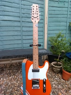

Morning all.
I'm trying to do something stupid to my 12 string telecaster again. Here's a pic
This time I'm going for onboard compression. I've picked the board I'm going to make (squishy octopus) and I'm just working out how to fit it and control it.
Currently, I'm thinking of have the controls as littlr trimmer pots under the pickguard, so I can set it and then leave it (once I find the sound I don't adjust my cs3 for example). So then I just need an on/off.
I think the idea of having a rotary switch as the on off, mounted on thelower horn, repicating the electric 12s looks.

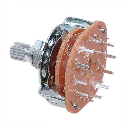

Obviously, this was a pickup selector. So, my question is, is it possible to get a simple on/off rotary switch that works like a stomp switch on a pedal? Or is it possible to wire something like these as for true bypass? s-l400.jpg
If not, I could always use a 500k push pull in the position and have the "level" setting adjustable, I just worry about it getting moved around. Or I suppose I could put a push pull in the position, but not wire anything to the pot.

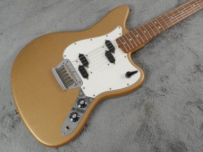

There's the Gibson Varitone switch from the ES355.
Think 'outside the box' a little, try whatever your local equivalent to 'Maplins' is (Radioshack?). Over the years, there have been amps and radios/hifi equipment that have used the kind of switch you want. Another avenue to explore is automotive spares stores. Again, many cars have used that kind of switch, especially prior to the 80s.
If I were doing it, I'd probably use a Fender Jaguar/Jazzmaster slider switch.

I did quite like the idea of the bank of three jaguar sliders, one turning it off/on and the other two as sliding pots, to control the level & volume, but I can't find the sliding pots. Presumably, the switch travel is too short for them to be useable.

If the sort of stomp switch you have in mind that would give you the action you want is (for example) DPDT, then you just have to find a rotary switch that is DPDT and wire it the same way. Likewise for 3PDT if you want to include an LED idiot light, etc.
Note that some of those rotary switches need a fair bit of torque for actuation so give some thought to how it will be mounted. The little tab on the side that we usually break off if it's a pot is there to help keep the orientation of the switch fixed, by having it poke through a tiny hole in whatever panel material is holding it; presumably that would be pickguard material or similar.
A toggle switch would perhaps not give the look you are after but might be easier to implement.

Thanks for your response, i've found this on RS components, i don't need an led, so i've looked for dpdt. This seems to give me what I want.
https://uk.rs-online.com/web/p/rotary-switches/1959353
And am I right in thinking, to go dpdt, I'd just ignore the middle bank of the 3pdt switch, thus getting rid of the led and the problem?
What is certainly true is that you would ignore one "bank" (one "pole", that's the P in DPDT and 3PDT), whichever one has to do with the LED. From the image you posted, as best I can read it, it looks like that would in fact be the middle column of three contacts in the blue box.
Another thing that is probably correct about the switch series you linked to is that it is ON-ON rather than ON-OFF-ON, because I think that is what you are looking for. (I could contrive a reason to want the ON-OFF-ON, but I suspect it's not what you have in mind.) You might also make sure the physical dimensions of the switch (see the data sheet) are ok for your application. And make sure you know that you can get an appropriate knob--the shafts look like they are fairly small diameter.

That's fantastic, thanks for the help, I think I'll go for that one, you're right about the shaft, but that's something I'm hoping to work around. There's a machine shop at work so I reckon I could get a little sleeve made, apart from that it looks the business, plus I can dremel the hole in a square roughy the right dimensions to avoid the torsion problem you warned of!
The "sliding pots" on the Jag and Jazzmaster are just mini-pots attached to a right-angled bracket, under the plate, with a thumbwheel that pokes through the hole in the plate.
Those are available from any guitar-parts store/site that caters for offset guitars, such as wdmusic, allparts, axesrus (in the UK).

So I could possibly modify this plate to take the rollers? Tempting, but I'm sticking to the idea above I think.
