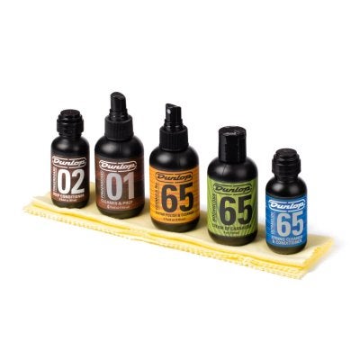

I have been using Dunlop's System 65 care products on my guitars for as long as I can remember 👍
I have an affinity for Rosewood and Pau Ferro boards, and I like their fingerboard kit which includes a cleaner and conditioner.
Whatever you use, too much and too often is just as bad as not enough. I am pretty generous when I put it on, but I wipe off all the excess, you don't need to slather it on and let it "soak in" either. Just put it on and wipe off the excess. I do my boards twice a year, just before the dry part of the year (typically summer) and then again before winter as the HVAC in heating mode is drying. Kind of like humidifying acoustic guitars, you don't want the board to dry out during the times of the year when the humidity is at its lowest.
