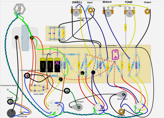

Hi guys,
I am about to build a Reverb Unit using the Triode Electric schematic but I got few doubts about the PT I should be using.
Being in Europe and operating in 230/240V I found the Hammond 261D6 to be as close as possible to the original specs.
Here come the doubts about the grounding as the Hammond got the CT for 6.3V and HT.
Also I guess I am overthinking but it is the first time (in my anyway very short experience about amps) that I see the second red cable of the PT secondary that goes to the main ground. Wiring it like that, should I not get a short to ground?
How do you think is the best way to ground the amp using the Central taps?
How about to follow the grounding of Rob's 5E3 layout?
Thank you in advance!
This PT with center taps will work... and a PT without a CT will work.
This is a very simplistic description of what is happening in a very small nutshell. Don't quote me, hah.
The PT is fed with 240VAC on the primary winding. The secondary winding will put out ~500VAC (red wire to red wire) when it is loaded in the circuit. The rectifier will separate the upper half of the waveform and the lower half of the waveform taking ~250VAC from each side of the secondary (red wire to CT). When the 250VAC is rectified into VDC, the voltage will be similar to a battery (DC). The B+ will be like the positive side of the battery and the CT will be like the negative side of the battery.
Try to *imagine* the secondary of the PT and the rectifier and the reservoir cap, (all three) as the *battery* that powers the circuit. (Just like a battery positive and negative.)
Think of powering a flashlight (torch). There is a battery and a load (bulb). The metal case (chassis) holding the bulb does not have to be connected to the battery for the flashlight (torch) to work. (A wire can do that.) It is your choice to use the chassis as a return path for the current or use a wire.
In our audio circuit each tube is a load. It is more complex than a flashlight (torch) where the bulb is the load, but it is very similar (just more bulbs, I mean loads). The DC is doing most of the work. Just like the flashlight (torch), the DC really doesn't need to be connected to the chassis and the chassis does not have to be a return path for the current.
That said... there is *some* AC we are dealing with and in an audio circuit we want to get rid of the AC we do not want to hear. We have some AC ripple current that is leftover from rectifying the AC to DC and we have some AC signal current from our guitar pickups. We want to connect the DC negative to the chassis (reference to ground) to allow the unwanted AC to return to ground through the power cord ground. (Like an actual rod driven into the dirt.)
What we want from the chassis...
We want a safety ground so we don't get zapped. We also want the chassis to act as a shield to keep out radio frequencies and other hash.
Of course it is much more complex than this. There is a lot to learn and that is where the fun is.

I reviewed the Triode Electric schematic. Imo, you would be much better off with the one suggested by @sudogeek
The Triode Electric displays a half wave rectifier which will be comparatively noisy. A full wave or bridge rectifier would be superior.
The ground scheme of the Triode Electric might create a ground loop when connected with other equipment. The one sudogeek recommended should keep that from happening.
I would make a small change to the schematic sudogeek provided. I would connect the HT CT directly to the reservoir cap to keep that distance as short as possible. See below.

Below shows the schematic for a bridge rectifier. It does not use the hardwired PT CT. It creates an artificial HT CT. If you use this type of rectifier, heat shrink and tuck away the hardwired PT CT. IOW do not use both the hardwired CT and the artificial CT.
Below shows wiring diodes to form a full wave rectifier using the hardwired HT CT. This is similar to the rectifier on the schematic sudogeek provided. (That schematic shows capacitors in parallel with the diodes. The capacitors help to smooth the switching action of the diodes to make it quieter. Capacitors can be placed in a similar fashion parallel to the diodes of a bridge rectifier to make it quieter as well.)

Yes just to the chassis. The chassis and the reverb tank metal surround act as a Faraday cage. It is just like shielding the cavities in a guitar.
Usually a guitar amp will have RCA jacks which are not isolated from the chassis. The shield of one of the RCA cables will connect the reverb tank metal surround to the amplifier chassis.

I put together what discussed so far, let see if I got it right. See attachment.
I have changed a few things to closer match the schematic sudogeek supplied.
You forgot to include the PT CT. I show it connected to the reservoir cap negative.
I moved the heater CT to elevate it to the 6k6 cathode voltage. (Alternatively this could terminate at the 6K6 pin8. It is the same place electrically. Use whichever seems more convenient on your build.)
I added the ground from the input jack.
I moved some of the ground connections so they stay with their respective ground nodes.
IDK the configuration of your chassis. The *buffer* board could be moved to the right, on this layout, to keep the wires shorter.
(If you are designing the eyelet board, I suggest moving the last filter cap to the location indicated in lavender. If this is a prefab eyelet board just leave it as is.)
The power cord typically has the *hot* line fused before the switch. I did not change it on this layout.
