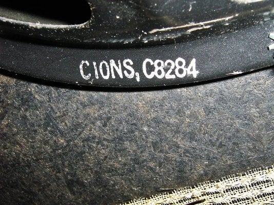

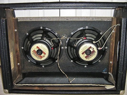

Hello....your post caught my attention as I have a 1965 all original Fender Vibrolux Reverb rated at 35 watts with C10NS speakers & they are marked C10NS. What size magnet(never measured it) should mine have? Here is a photo showing the stamped C10NS & C8284 rim.
Thanks!

The C10NS is basically a C10P with the higher wattage rating of the C10N. The C10P had a 16 oz. magnet. Fender spec'd the C10NS for use in the Vibrolux Reverb and they can be found in some Princeton and Princeton Reverb amps. The C8284 number is a production "lot" number. By late 1965 the Fender part number took the place of the model designation. This helped the factory keep inventory and pick parts by a numbered system. So, C10NS was dropped from the rim and in its place 023036 became the part number for the Vibrolux Reverb and 023010 was used in the Princeton. Other branded speakers, like Oxford and Utah, also received this numbered code so it's not specific to Jensen.
Here's a side by side photo of a C10NS and C10P.

VV53, you're welcome. Yes, the C10P and C10NS both have a 16 oz. magnet where a C10N would have a 28 oz. magnet. The C10P was a 20 watt speaker where the C10N was rated @ 25 watts. The C10NS retained the magnet size of the C10P yet had the higher temperature 25 watt voice coil of the C10N. I believe Jensen used the "S" designation, following the model type, to imply a special order.
