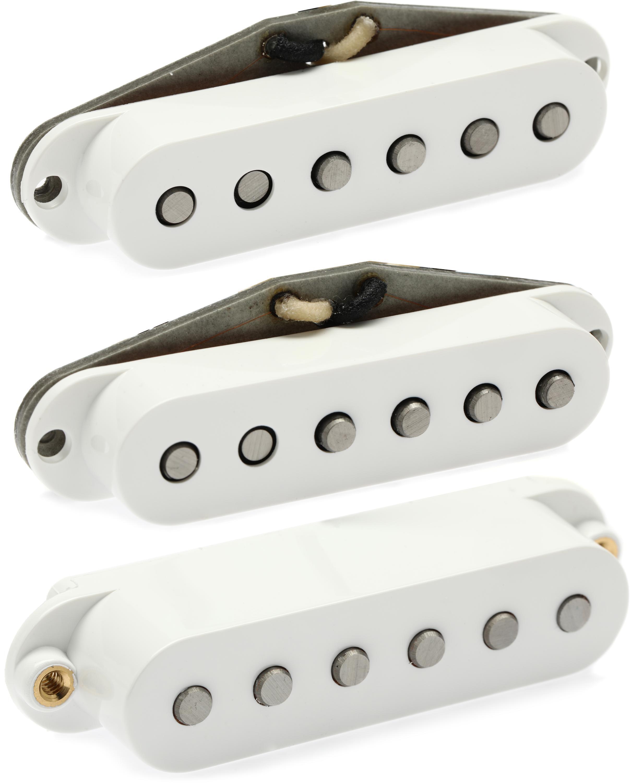

So I just got my axe from the shop recently. There's a few awesome mods I got, the guitar looks and feels awesome! And I got pickups installed there as well. However, I noticed that the bridge pickup is A BIT too high. And when I tried to adjust it, I felt the screw do a weird "springy" feeling. I can loosen it and the screw comes out but I tighten it and that pickup just gets higher to the point of hitting the string. My intonation is off due to this, there's some weird octave thing going on.
I really don't want to go back to the guitar shop as this is something I could probably fix myself. So what do I do? Is there a way to fix it without having to de-string the guitar?

This is the key. The pickup (or the screw) is catching on something - probably the guard cutout is slightly too tight somewhere. Try loosening the screw, then actually pushing the screw down. Chances are it will stay down. If that works, you can either sand the edges of the cutout or just get the pickup to the right height and leave it alone.

You said it’s a stacked pickup? It may not adjust down because it may be taller than the original pickup and now it’s already sitting on the bottom of the cavity. If you want it to sit lower, the pickup cavity may need to be made deeper.
Not saying that’s definitely the issue, just saying I’ve had it happen.

OK. I've read all the suggestions so far. There's not enough information for me to figure out just what your problem really is. First is it a Strat or a Tele? And is the pickup a side by side configuration or just wound around itself in two directions (humbucking)? Meaning that if it's like the side by side then I can understand thinking that it's the pickup but I'm thinking that if it's the screw the spring inside might be compressed against the hole in such a way that the ends of the spring where it finishes is open - think of it like the key chain effect. If this gets caught up inside the hole for the screw the spring end will catch and keep it from being easy to adjust. I've had I don't know how many guitars go through my hands over the last thirty years - hundreds? But this has happened I can't tell you how many times. Do you have any pictures of this guitar so that we can help you a little better? Otherwise you shouldn't be embarrassed - take it back and have it made right.

The set is this specific one:
I'll update tomorrow as I check it out and find out more, unfortunately it's time for bed :(
