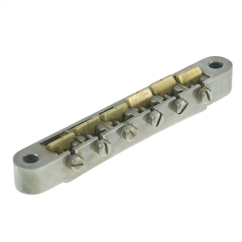

I'm closing in on the finish line on this build, but I have a question about the bridge assembly. As I'll be using a Les Paul vintage style bridge and tailpiece assembly and have never tone this type of bridge before, I want to make sure I'm approaching it correctly. I've searched d'interweb to answer my questions but can't find solutions specific enough for my situation.
I wanted to go all vintage correct, so I went with all Faber parts:
The stop piece section seems fine as far as I can tell, but regarding the bridge / studs & thumb wheels section, I have a few questions:
I'm pretty sure I drill two 3mm holes for the bridge studs, but how exactly am I supposed to screw them into the body? There's no way for a screw driver to screw the studs. I'd expect you to be able to use a flat head screw driver on these, but there's not notches on the for studs for this purpose.
The only way I can see how I'd screw them down, would be to super glue the thumb wheels to the studs (far down enough so that the top of bridge would be flush with top of studs when bridge is sitting on thumb wheels) and screw the studs down by turning the thumb wheels, but that just doesn't seem like the correct solution to me. I guess I could file a notch on each of the studs to accept a screw driver, but again, these parts are pricey, so whey would they leave it to the customer to do this?
Also, when the bridge sits on the studs and thumb wheels, there's a small bit of wiggle, not a huge amount, but a little and enough to worry me that it could cause possible intonation issues and other possible issues. Is there a remedy to this? I was thinking a thin metal tube that could fit into this gap might work.

The best way to install the studs for the bridge is to first drill the holes and then tap them so there are threads to match the studs. (Not sure what size threads Faber uses on their studs, but they can tell you. Probably M4-.7)
To actually screw the studs in, start threading them by hand. A little wax can help. To finish the job, put two nuts on the stud, tightening the top one firmly down on the bottom one with a wrench. Works best if you use two wrenches so you can turn the nuts against each other. The two nuts will lock together and then you can twist the whole assembly down into the guitar. When it's at the right depth, use your two wrenches to loosen the nuts and then take them off.
The bridge should have about 1/2 mm of slop. When the strings are under tension, they'll press the bridge forward against the studs and it won't be an issue. If it really worries you, you could try to find some thin-walled brass tubing that's the right size, but it seems like more trouble than it's worth. TonePros "solves" this issue by drilling and tapping for set screws that tighten against the studs.

First make sure those holes are dead on because you don't have much wiggle room. With an ABR-1 bridge, I've drilled my pilot holes first and then double nutted the knurled adjustment wheels together and screwed them into the holes. It would be far easier to get a bolt with the same threads and make a " tap" and tap the threads into the wood. If you can buy the extra long studs you should be good. I haven't experienced that many studs leaning forward except of vintage instruments where they probably used Black Diamond strings on them. The bridge should get about 1/8" more angle on the bass side in order to intonate the saddles. The Nashville bridges have more travel to them too.
Find a Phillips screw of the same diameter and thread pitch (take a thumbwheel to the shop with you to match it to). Clamp the Phillips screw in a vise and use a small triangle file or a Dremel to cut straight flutes in the first five or six threads on opposite sides. Drive this screw all the way in, remove it, clean the screw threads with a small wire brush, and repeat on the same hole. Do the 2nd hole the same way. Blow out each hole with compressed air, and install the bridge studs using the 'jam nut' method described above.

I use a cap nut to put the studs in, works fine. You may want to wax the threads on the studs, where the cap nut goes on, so it is easier to remove later.
A little wiggle on an ABR is pretty common, I'd say, but you can also get a locking type ABR (also from Faber) to make it non wiggly.

I agree with buying a tap and tapping the hole. It's nice clean work that way.
To screw a headless stud in, use two nuts and jam them/tighten them together. You can then use a small socket to screw the stud in.

It will be very difficult to thread those studs in without tapping a hole unless the wood is pretty soft. Try it on some scrap wood first, of course. It will help to put a small chamfer on the edge of the hole, but you don't want to overdo it because it will look bad. Be especially careful if it's already finished as it's super easy to chip the paint.
If you don't want to buy a tap, use the method that Peegoo described to make your own out of some steel screws of the same size and thread pitch. Faber can probably tell you what that is if you ask. Here in America, the hardware stores usually have a thread checker so you can verify the thread size of those studs. No idea what it's like in Ireland.

The studs are like machine screws. They need " nuts" to be installed correctly. They are not tapered like wood screws and don't cut their own threads easily, but can do it with effort. You don't want to damage the studs or threads by beating them in either.

You have receivedf a whole lot of information, mostly pretty good. I'll give you my opinion for what it is worth.
There are three variations of the tune-o-matich bridge, based on how they mount to the body. The original Gibson bridge used on the iconic les pauls of the 1950's is the ABR-1. The mounting system for that is a machine stud (basicaly a bolt without a head) that is threaded into the maple top and mahogany body. Gibson used studs with 6-32 imperial threads, that is a fairly small diameter and fine thread that was intended to be threaded into metal, it is not a wood thread. Some manufacturers who make copies of the ABR-1 use a metric M4x.7 thread - not the same as the 6-32. The stud is screwed directly into the wood - to do it correctly you should use the appropriate tap to cut the threads in the wood. Some studs have an allen head which allows them tot be turned with an allen wrench, some do not and the old mechanics trick is to put two nuts of the appropriate threading on the stud, jam one against the other and turn the stud into the wood with a spanner wrench.
Because the ABR-1 was used on the vintage guitars many people feel that it is one of the keys to that sound so the ABR-1 continues to be used and some folks even convert their modern guitars to the 6-32 stud. However the use of a machine stud is really not ideal and two newer versions of tune-o-matics have come on the market - the so called "Nashville" and "modern" version, both which use inserts driven into holes in the top that the adjustable stud threads into. I prefer the modern one and that is what I use on all of my guitars. If you go to a site like StewMack and search for Tune-o-matic bridges you will see all three - with specifications on stud spacing, hole size and so forth. The StewMac fret calculator will help you with locating the stud holes relative to scale length.
Any of the bridges will work, they are not compatible with each other so you need to buy them as an assembly and drill (and tap) the correct size hole.
Here is locating the stud holes on a modern bridge - I put the correct size drill bit in the bridge and once the bridge is correctly located, tap with a hammer to transfer the hole centers, then drill on a drill press
Your holes will be smaller for the ABR-1, then you run the tap into the hole to cut the threads. Your stop bar will be pressed into its hole.

My chart says a M4x.7 tap uses a 3,3mm hole. When you buy the tap get a "tap handle" that allows you to turn it. Drill the holes with you press and tap the holes by hand (slowly). Probably worth doing it in a piece of scrap first
