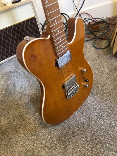

Big bold cleans sound like a humbucker for sure. My advice is don't mod the Tele, take the $200 and go buy a used humbucker guitar. I had a guy short $150 cash on a deal and he threw in a Korean Schecter shredder to make up for it. Pickups are fantastic.
I agree don't mod the tele.
I bought a Scheter PT Van Nuys and the pick ups are fantastic ! So much so I'm always grabbing it when playing with band. I absolutely love my tele but that Scheter is something else altogether, 2 humbuckers and a 5 way switch.
