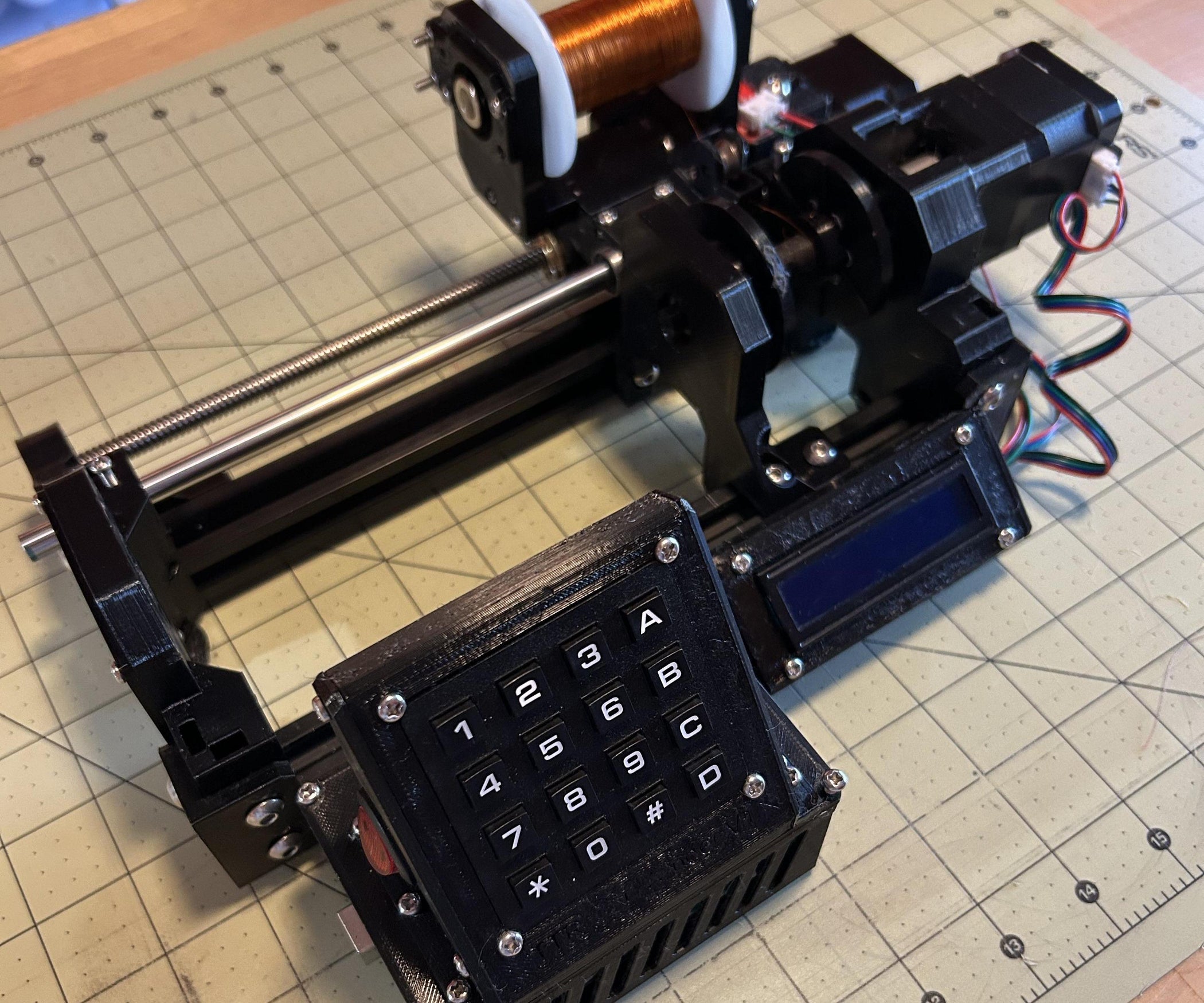

Perhaps you should take a look at the various winder threads that the forum has to offer.
You will need a speed controller, digital readout, hardware to make it, something to hold the bobbin, something to rest the wire on....etc.
Use the search feature up in the upper right and type pickup winder.
This is the first one up:
This isn't here but will help you understand what you need:

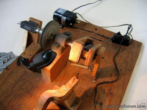

The winders in the links that the other posters posted up are some really nice designs - they use micro-controllers to control the various functions of the stepper motors.
Here is an early winder that Paul Bigsby made up for winding his original pickups -
It worked for Paul Bigsby !!!
A winder that will work doesn't even need to be as fancy as that one.
A variable speed motor, some means of attaching the flatwork or bobbin to the motor shaft, and a simple guiding arrangement for your coil wire will get you started.

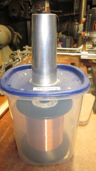

I usually keep my coil wire in plastic containers - they are easy to handle and store, and also protect the wire from getting beat-up.
As long as the coil wire can spool off without any interference - you're good.
It's not necessary for the spool to rotate as the wire spools off - the spool can remain stationary while the wire spools off - the slight twisting effect this has on the wire doesn't affect the wind.
