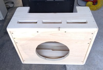

    As a covid project I have decided to build a pine cab for my Peavey Bandit red stripe.
    It will be exactly the same as stock so I can use all the existing parts, corners, handle, baffle, grill etc.
    I've yet to decide on a finish, paint or stain but I have plenty of time.
    Here's some pics of it in it's infancy. IMG_20200924_150213193.jpg IMG_20200924_150221128.jpg IMG_20200927_085334083.jpg IMG_20200927_085435626.jpg IMG_20200927_133228106.jpg

    Michigan
    Bandit gets a new home!Thats looking good!
  3. reactor99

    I had done the same thing with a Vox VT50 and if I remember correctly I reduced the weight by 12 lbs. I painted it red cause it goes well with the white knobs. I am also curious how much weight I can drop when I finish the Bandit. PSX_20190714_125839.jpg PSX_20190714_124737.jpg PSX_20190714_125059.jpg

    Peavey Bandit coming along. Still more sanding and shaping to be done to get all the corners right.
    Then I'll remove the screws, drill out the holes and glue in wooden dowels and sand some more.
    I thinking maybe a transparent barn red for a finish. Coupla more pics to give you an idea of how it may look. IMG_20200928_183742954.jpg IMG_20200928_183725553.jpg

    I removed the screws from top and bottom of cab. Then drilled out 5/16 holes where the screws used to be. Then glued in 1 1/2" long pieces of 5/16" wooden dowels. When they dry I will sand em down. This way the bare cab will not have any metal in it.
    I glued and screwed in the rear baffle. The stock piece was 1/2"x 4" mdf. I replaced it with a piece of 3/4 x 10" pine ( actual width is 9 1/4") basically closing off half of the back of the cab.
    Using 2 highly accurate bathroom scales I found that the stock mdf cab with no hardware is about 21.5 lbs. My pine cab which still has 9 screws that need to be replaced with dowels and still has alot of sanding to be done weighs in at 12 lbs. So the bandit will be losing almost 10 lbs of weight. IMG_20201001_142152270.jpg IMG_20201001_142139428.jpg IMG_20201001_142218020.jpg
