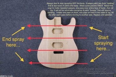

Black is one of the hardest colors to spray and get it to look perfect. When I'm shooting color I might use 2 or 3 coats of vinyl sealer, 6 or 8 or more coats of color, 12 or so of clear, Sand to 320 between groups of three, get the last clear coat as good as you can, wet sand to 2000 and buff. Depending on the wood you may or may not need to pore fill.
ps - get the little nozzles that StewMac sells, they give a much finer pattern than regular rattle cans. They can be cleaned in lacquer thinner after each use.

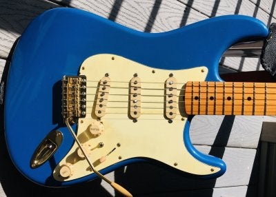

This was my first finish job from a few up years ago, all spray cans. Reranch LPB & Deft Gloss lacquer from Amazon.
I didn't use a primer or sealer, it's about 4/5th's of the LPB can & half of the lacquer can...I want it to age. I sanded it very smoothly to start, so skipping those steps wasn't a problem, the first couple of coated of LBP were greenish though without a primer base.
Later I checkered the finish with a $20 space heater & 3 cans of compressed air. Heat up the finish and then quickly blast it with an upside down can of compressed air.
Honestly it's not hard...if you study up on it a head of time. LOTS of good tutorial videos out there...and if you screw up, sand it bare & start over. Had to do that once on another project when I rushed & did pay attention to humidity.
I'd skip Reranch & Gracey's & use Dupli-Color car paint...1/2 to 1/3 of the price and there's a ton of color options. That's what I've used on my last couple of projects.
Two $20 space heaters from Amazon during the wet paint & lacquer on the body will solve that.

+1 on the StewMac nozzles - far easier to do it right than with the standard rattle can nozzles.
Trick I learned recently goes back to how Fender used to paint single-color bodies. They had a board with 4 nailheads sticking up that they'd balance the body on top of. Then spray the top HORIZONTALLY so the danger of runs is somewhat less. It's tempting to hang the piece up and shoot it, but you're asking for runs when gravity turns on you. Instead of a board and nails, I put a kleenex box down on my bench and covered it with a towel and then set the guitar on top of that.
A friend also made a special stick that's the size and shape of the proximal end of a neck. It has a hook on the other end to hang from. Two screws go in just like attaching a neck, and in addition to making it easier to handle the body, it protects the neck pocket from getting paint in there and gumming things up. This lets you hang it up and shoot the back of the piece VERTICALLY if you want, but watch those dagblamed runs!

^^^ I always shoot my guitars laying flat on their back or top (I don't do the lazy susan with nails however). I can walk around the guitar and control the amount of finish and the pattern on the sides. I tried hanging a few, just wasn't good enough to make it work.

I also like to paint my bodies laid flat.
The reason I ask if this is your first attempt is that black is very unforgiving by nature of its reflectivity. Imperfections stand out and you must use a sanding block (rigid for flats and flexible for contours) as your fingertips will leave ridges and waves in the finish that are visible when you angle the surface to the light. You can hand sand but must use a light touch with the side of your hand, not your fingertips.
If you can spray even coats without runs and sand a surface dead flat for buffing and polishing, you can pull it off, especially in lacquer. If not, you should prepare practice pieces and finish them from primer through buffed-out final finish to practice your technique.
The painting process is no different than any other color, it just requires higher standards of preparation, wet sanding and buffing. The better your prepared surface, the fewer clear-coats and wet sanding will be required.
